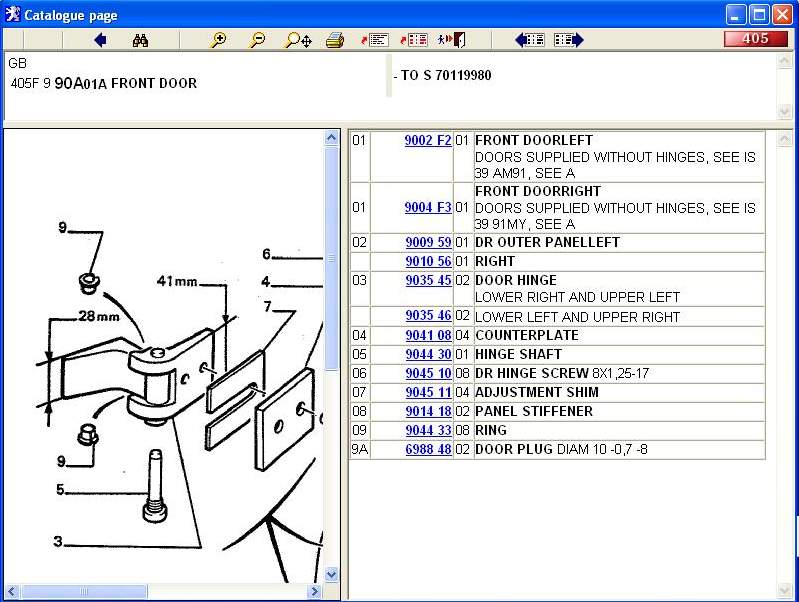

Look at the attached pic from the parts cd.
Anyone got any idea what item number 9 is for? There's two of number 9 and it kinda looks like they sit within the hinge.
pugbliss
it kinda looks like they are the screw bit which the torx bolt goes into. could be wrong
they look like bushes to me, but I have yet to need to look closely at a door with this type of pin.
futura
Isn't part #9 the little caps that prevent water from going in the hinge?
