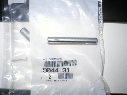

futura
Sorry I didn't come back on this thread earlier.
The door pins from Pug are 49mm long and roughly 7mm diameter. Part # is 9044.31 and they are £2.42 for the pair +VAT.
Pic attached -_-
Edited by futura
Pic attached :(
aaah! good thing you mentioned that Futura, the guy seemed to think they came in packs of 5 :angry:
