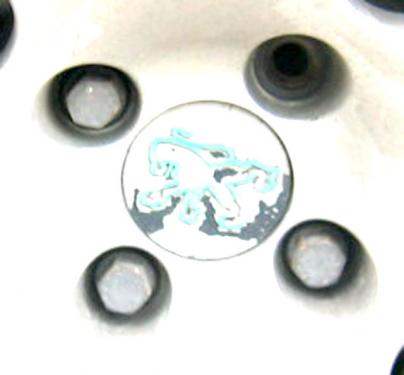

vern 0 Posted January 2, 2007 What bolts have people used with this type of wheel it looks like it uses a taper seat but I am not sure, as it looks like it could also use the standard flat washer type as it has a recess for washer. Also what length are the bolts?. Any info would be greatly appreciated so I can buy the bolts. Share this post Link to post Share on other sites

cybernck 403 1 Cars Posted January 3, 2007 to me it looks like you can use either a flat or a cone bolt sorry for the crap pic, had to adjust the levels to make the hole more visible. Share this post Link to post Share on other sites
vern 0 Posted January 3, 2007 Thanks for all the replies. Cybernck thats exactly what I thought, could use either. I had searched the boutique site but found nothing useful. Shine and Gentrix just what I wanted many thanks I can get these ordered now. Share this post Link to post Share on other sites

JERAM 0 Posted January 4, 2007 Jeram do you wheels look the same as the ones in the picture Cybernck posted?. With 1.6 GTI wheel bolts. Share this post Link to post Share on other sites
