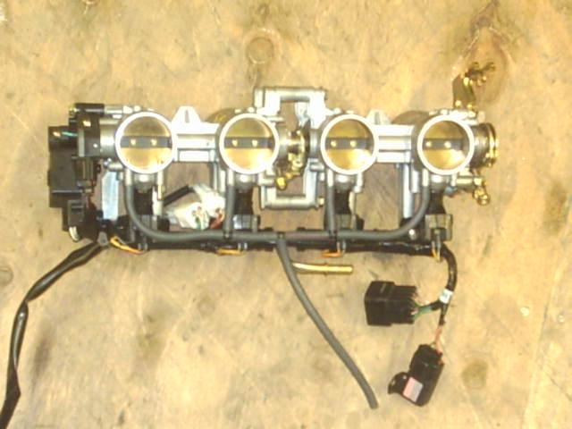

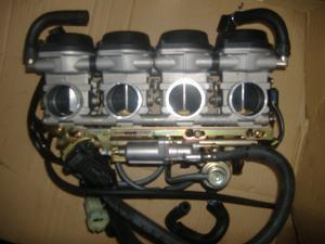

Richie-Van-GTi
top pic is R6 carbs, the one below is bodies which will explain the big price difference.
Rippthrough
Nope, both are bodies

Dream Weaver
The R6 ones shown are carbs, GSXR etc are bodies - the comparison would be Weber 45's vs Jenvey, and being in 2006 i'd always go for the more modern TB's.
My TB's cost £63, but that was before they were that sought after <_<
Rippthrough
No the R6 ones are bodies! And mine cost me £37 with regulator, tps, map sensor and pipework.
Edited by Rippthrough

Rippthrough
  pugpete1108 said:
the ones bales is selling look different form the ones i have seen on ebay, they appear to have electronic injectors on them . could be wrong!
They are bodies, I have a set right here in front of me!
pugpete1108
do they have injectors fitted or jets?
Rippthrough
Injectors, and a TPS, and a MAP sensor and fuel pressure regulator.

Rippthrough
  pugpete1108 said:
oh right, i know nuting!! <_< , still quite bulky though?
Not really, only difference to most bodies is they have vacuum powered CV sliders to help with fuel homogenisation at low rpm - helps with the throttle response. Makes them about 10mm longer than most bodies, but its not really a problem.
A lot of what you see there is surplus hosing and wiring - the wiring loom is triple wrapped and secured to the bodies in the bottom of that picture.

bales
<_<
I am getting a bit confused by the replies on here, are you saying that ones at the start of the thread are bodies or that the ones i am selling are bodies.
I can confirm that mine are without a shadow of a doubt carbs, but to be fair the ones in the picture look very similar to mine just without the throttle trumpets on.
I dont see how you can see that they have injectors on since we can only see one side of them, the only difference to mine is that they appear to have some more plumbing on with a pressure regulator.
Yamaha seem to have made lots of little changes to the carbs over the years so I am not sure how you can tell they are bodies from what you can see. I also (though I could be wrong) have never seen diaphragms used in throttle bodies.
In some of the later R6 bike engines that we had at uni that were injected the bodies didnt have vacuum sliders in them they were just well....throttle bodies with a butterfly and injectors in.
