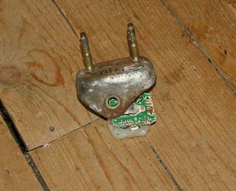

pug_ham 245 3 Cars Posted December 30, 2006 If the front mount plates had been fitted on the wrong sides the beam would be a nightmare to fit as the rear mounts would also be out of line, even though the beam holes are slotted. They are handed as well as the bolts being offset in the mounts so with the both crossed over they would pull the beam forwards in the arch not push it backwards. Maybe its something as simple as the rear valance has been knocked & its just sat like that which looks wrong but the beam & everything around it is fine. I know that dreamweavers car sat like this before we fitted his refurbshed beam & now its fine but nothing has been changed apart from the beam refurb. (it is a different beam though). Graham. Share this post Link to post Share on other sites

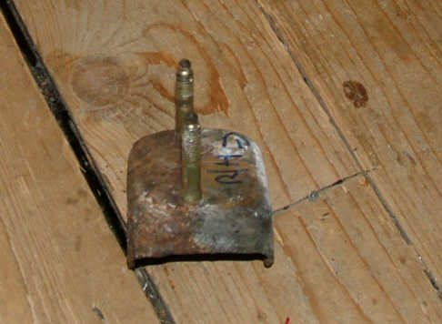

welshpug 1,675 Posted December 30, 2006 (edited) problem solved :vbg: the only thing I could think of was that 1900 mountings are offset (didnt see your post there graham! I was out before the computer came on today!), and I remembered from rebuilding the beam that they did have D and G on them. someone on earlier site kindly measured the gap between their wheel rim and the lower edge of the rear valence and got a measurement of 115mm, I measured mine - just about 100mm I then whipped off - the rear mounting bolt it was obvious from there that the beam should be a bit further forward. and from this pic you can see that theres just about enough room for it to move 15mm down came the beam got this far then remembered about the strap in the middle of the beam :doh: ET VOILA!!! one beam dropped off the car (didnt have to disconnect the hoses, just unbolt the brackets where the flexi's meet the rigid pipes. I'm glad I plastered loads of copper grease on everything nearly 3 years ago because the bolts came undone easily, definitely a :doh: moment when I see the "D" on the bracket - as you can see from the picture[/url] the studs are offset. and they do put the beam too far back when theyre on the wrong side!!! Swapped the mountings over and bolted it back up and now it looks just fine, no chance of rubbing, went out for a test drive and it didnt rub at all, even when I was gracefully sideways on a damp roundabout :whistle: edit; image file sizes, 120k max please. Edited December 30, 2006 by pugtorque Share this post Link to post Share on other sites
newdean0 0 Posted December 30, 2006 welshpug said: the only thing I could think of was that 1900 mountings are offset (didnt see your post there graham! I was out before the computer came on today!), and I remembered from rebuilding the beam that they did have D and G on them. Are the 1600 mounts not offset then? Might explain a problem I've been having. Share this post Link to post Share on other sites
welshpug 1,675 Posted December 30, 2006 nope, they're the same either side as are 309 brackets. apologies for the size of the pics! Share this post Link to post Share on other sites
