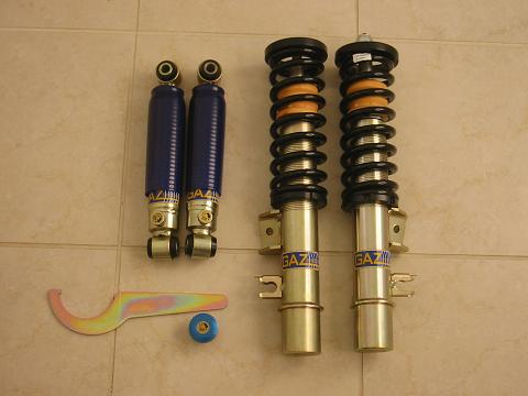

Thought id treat my self to a early xmass present in the form of some new suspension. :D Guess whos been a good boy this year <_<

kyepan
what length and stiffness springs did you order?

I got them from ebay for £225 inc postage and they hadnt even been opened. The springs are 8" 250lbs - will that be ok for road use? you got me worried now...
yeah ill try and find a nice day over the xmass break to get them fitted and report back.
johnrobertgordon
I'm not sure but I feel 250lbs is a bit harsh? Don't quote me on that though, I could be wrong.

Im doing a search and it looks like it is a bit harsh for road use. Ive got a 2.0 8v turbo to go in so maybe that will help things with the added wieght? Ill try em out and see how it goes, can always change the springs and keep these if i do a track day

yer i would go for some 10" ones, as i found the 8" ones didn't have enough travel for back roads. stiffness is up to you, 250 was harsh, 200 feels less welded to the road. its a balance and personal choice i guess. mine was an mi16 engine.

im going to try the springs as they are as i like a solid ride, but if I feel its too harsh i will change them. Just been thinking and ive been in wurzels car which was quite solid. his setup 23mm Torsion bars, 25mm ARB, Group A solid beam mounting kit, GAZ Coilover shock kit with 275lb front springs.
Has anyone found a way to do the top nut up? As ive noticed it doesnt have the hole for the allen key?

Hold the shaft with either a strap wrench or an old fan belt.
