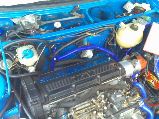

ANDYMISIXTEEN 0 Posted December 17, 2006 Have i got my hoses right on my Mi16? I havnt got the metal pipe that runs along the back of the rocker cover,do i need it? Heres a pic of how far i got earlier just need to finish them off if ive got them right http://i53.photobucket.com/albums/g56/DJMI...17122006409.jpg Top heater matrix hose to right hand side of coolant splitter (back of engine @ the bottom) Lower heater matrix hose to side of head Left hand side of coolant splitter to bottom of header tank Left side of header tank to radiator Right side of header tank to side of head Side of coolant splitter to rad Share this post Link to post Share on other sites
Richie-Van-GTi 71 2 Cars Posted December 17, 2006 sounds right to me although Id of done lower matrix pipe to coolant splitter and top one to side ofhead, just so they dont kind of overlap. No difference in it though, wont effect performance. Share this post Link to post Share on other sites
pug_ham 244 3 Cars Posted December 17, 2006 Sounds right, just the same as they were with the 8v engine fitted. Graham. Share this post Link to post Share on other sites
ANDYMISIXTEEN 0 Posted January 5, 2007 http://i53.photobucket.com/albums/g56/DJMI...1/mi16side2.jpg Do i need this metal pipe or can i just run a hose? Is it best to run the pipe because of the heat from the manifold? Share this post Link to post Share on other sites
Miles 331 1 Cars Posted January 5, 2007 Ditch the pipe and blank both ends off Share this post Link to post Share on other sites
ANDYMISIXTEEN 0 Posted January 5, 2007 Ditch the pipe and blank both ends off Whats it for, where does the coolant flow to? How would i blank them off? A small hose with a bolt in the end? Share this post Link to post Share on other sites
Miles 331 1 Cars Posted January 6, 2007 For that pipe to work as it should there might be a 2 stage stat in there, Most get replaced with a normal stat and it doesn;t really work then, It's just to get heat to the heater quicker I think To blank off you can do that, or use some bung's that come on some BX16v engine's, Tig the housing up and change the rear water housing to the std 205 one Share this post Link to post Share on other sites

pug_ham 244 3 Cars Posted January 6, 2007 Hold on a moment I thought the pipe that comes from the bottom of the expansion tank/bottle goes to the collant inlet at the rear of the engine that feeds in to the pump? Am I right? It does & still will do whatever way you plumb the Mi in. I prefer to plumb them in by blanking off the metal pipe & using the cooling system pipework from the 8v with the 8v collector on the block instead of the Mi one like this. The oil cooler / heart exchanger is optional, some use them some don't. I'd use the late PAS 205 remote oil water heat exchanger on one. Graham. Share this post Link to post Share on other sites
taylorspug 7 Posted January 6, 2007 Mine is plumbed in as Graham has stated. As far as i can see its certainly the simplest and neatest way to plumb everything in, which was a factor when i did my car as i didnt want hoses running everywhere (more to go wrong!) Im running the 8v water distribution block and also the 8v top hose/thermostat cover. Share this post Link to post Share on other sites

ANDYMISIXTEEN 0 Posted January 7, 2007 Am i best of getting an 8v thermostat housing and coolant splitter? Isnt it worth running the extra hose to have more water in the system, even if its a small amont? Share this post Link to post Share on other sites
taylorspug 7 Posted January 7, 2007 You can do, it wont give you any advantage having more water TBH, although if you use the 2 stage stat maybe the heater will start to work quicker! It really doesnt matter what combination you use, as i say mine was done that particular way because i feel if nothing else it makes the whole install look a bit tidier. Pics of mine are in my sig by the way... Share this post Link to post Share on other sites
