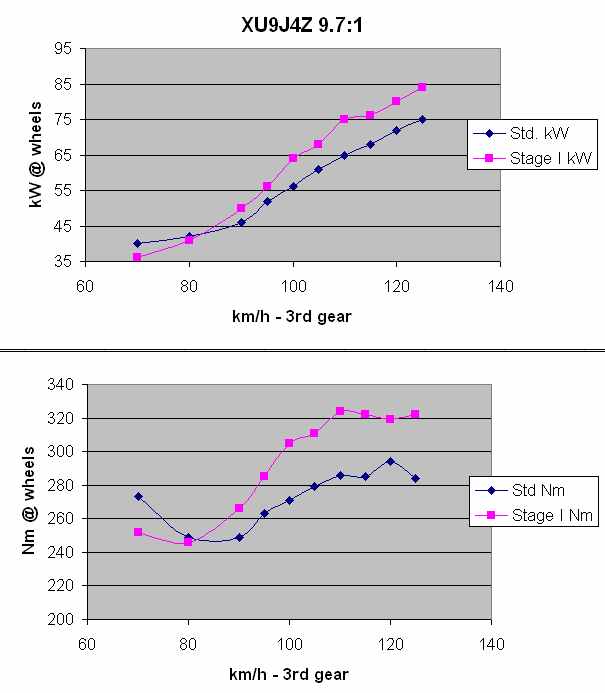

petert 607 Posted December 19, 2006 The Stage I works fine on the XU9J4Z which has only 9.7:1, but works better with more. The engine in the graphs was fully rebuilt with an OEM piston/liner kit. The two dyno runs were two days apart. The best I've seen with a Stage I (10.8:1) is 101kW on the same dyno. Share this post Link to post Share on other sites
gti_al 1 Posted December 20, 2006 Nunoserrano has a Stage I and another member is the process of buying one. I've driven a couple of cars with your cams in... they definately feel different. I haven't driven the other cars for long, but they definately felt more frantic up top. The owners are very happy with them anyway... I'll be in touch when i get something worth playing with. Share this post Link to post Share on other sites

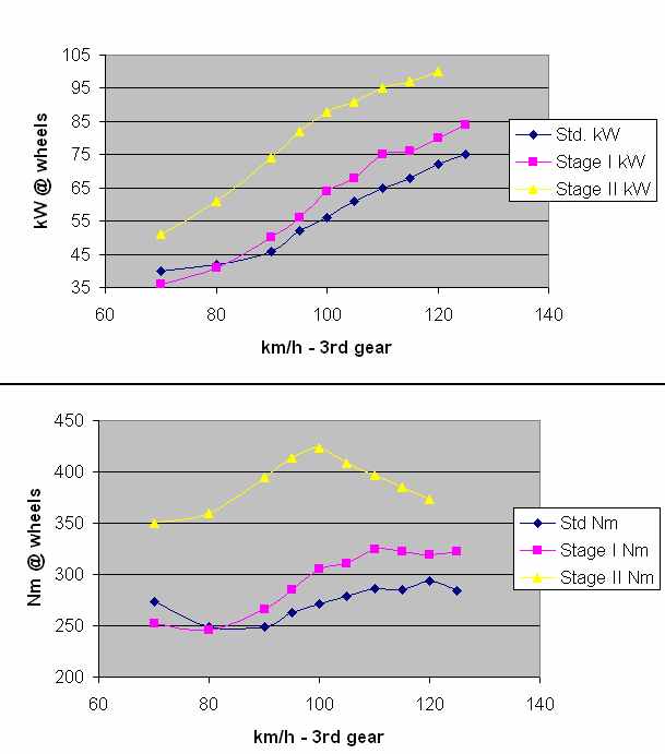

Anthony 1,003 Posted December 20, 2006 I've sent you a PM Peter, but given this is probably of interest to more than me, do you have a back-to-back dyno run showing the Stage 2 cam again standard and/or a Stage 1 (which I believe is similar to the Catcam's 4900526 inlet only)? Share this post Link to post Share on other sites
petert 607 Posted December 20, 2006 Do you need extra shimps under the hydraulictappets, cause they are regrinds, or will they just fit in?andi No shiming is necessary, as the preload in the lifter takes up any clearance. They bolt straight in. Anthony. I do have some dyno figures for the Stage II cam fitted with a std. inlet manifold, but I'll need to overlay them with the others above. Share this post Link to post Share on other sites
petert 607 Posted December 21, 2006 There's quite a big difference in power and torque figures, but please take notice that the Stage II cam is fitted to a race prepped engine - 10.4:1, serious BV head, std. exhaust cam, std. exhaust headers, std. inlet, bigger injectors, Haltech ECU. When fitted with 45mm TB's power jumped another 13kW. The Stage I cam is fitted to a bog stock low compression Mi16 engine. Share this post Link to post Share on other sites
TB_205GTI 1 Posted December 21, 2006 clearly there is something VERY wrong about thoose torque figures.. 300Nm on the wheels on a 1.9L engine.. Share this post Link to post Share on other sites
Rippthrough 98 Posted December 21, 2006 clearly there is something VERY wrong about thoose torque figures..300Nm on the wheels on a 1.9L engine.. Could be the actual wheel torque without taking gearing into account? Share this post Link to post Share on other sites
petert 607 Posted December 21, 2006 clearly there is something VERY wrong about thoose torque figures.. "Nm @ wheels" = flywheel torque x gear ratio x FD ratio x wheel diameter x dyno operator fudge factor Share this post Link to post Share on other sites
