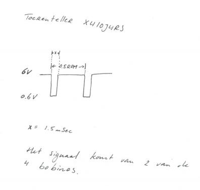

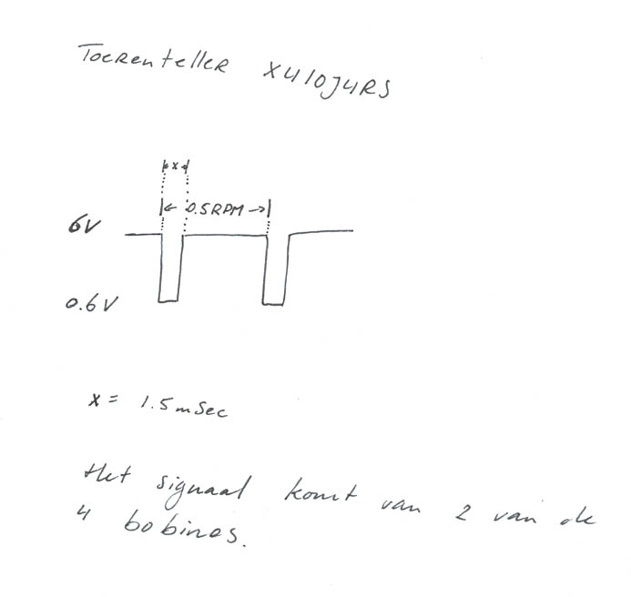

jochem
I've had my gti6 on the scope, the guy who helped me gave me this drawing:
