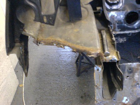

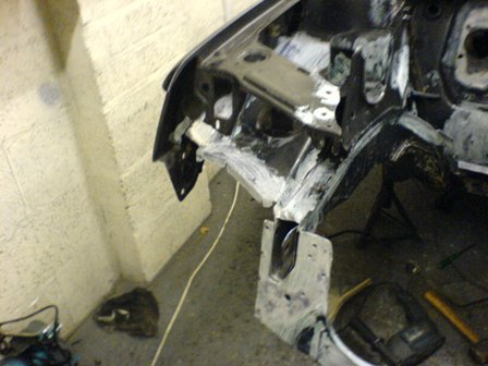

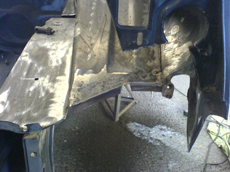

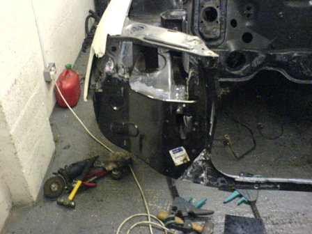

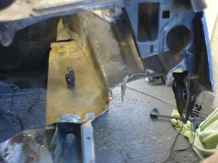

Will take a few pics after stripped old panel off as there is not a lot to see till then, like I said hopefully (fingers crossed) will not be to bad.
vern
Well the rust was not to bad as can be seen
Last Legend
Vern,What did you use to remove the old stonechip?Why did you feel you had to remove it surely it would have been offering some protection?What did you use to replicate the original stonechip you removed?
