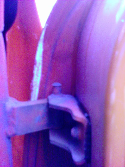

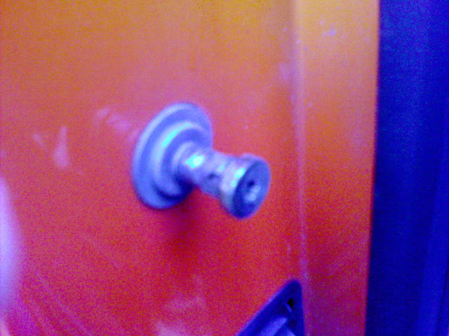

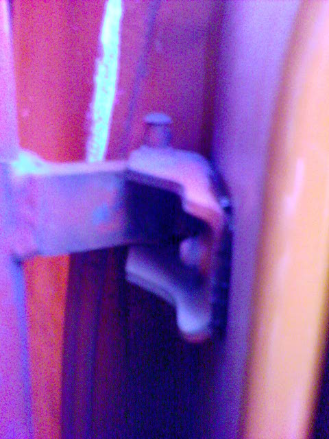

post-3718-1163263152_thumb.jpgpost-3718-1163263136_thumb.jpgpost-3718-1163263169_thumb.jpg
these are the pics of what im on about....
doese anyone know what sort of pins these are????
also how do i get oversized pins????? do i just ask for them????
all help needed
right, I asked about them today and they're NLA!
they are still on the price file so you may get lucky and find a dealer with them in stock, I was advised to use a suitable bolt and nut :)
