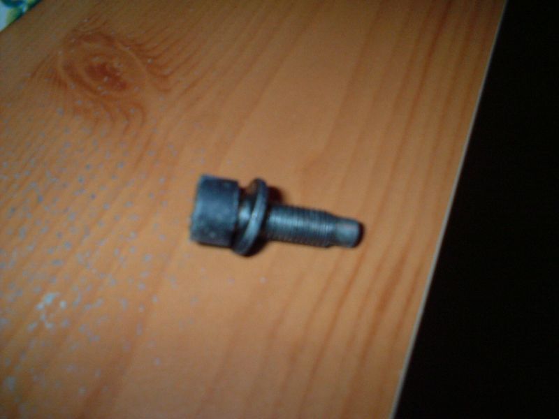

Can I just confirm that the bolt in this pic is a clutch cover bolt. My engine came with a box of odd nuts and bolts and I think these are the right ones. They have an allen key head (6mm iirc) and screw into the flywheel fine. Cheers
Edd-XS
Yep pretty sure those are the ones mate :rolleyes:) if it fits into the flywheel nicely and you got 6 of them then im sure they'll be fine anyway!

Hope that pic answers your question!
