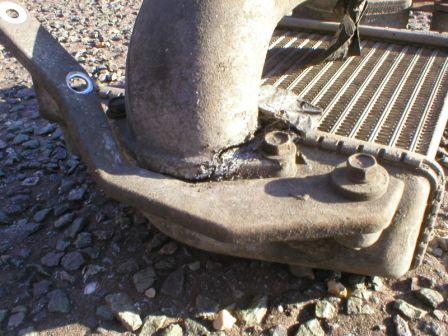

jim21070 2 Posted November 4, 2006 And here was the probem. A cracked intercooler elbow. Seems corrosion takes hold under the gasket which forces the flange apart and cracks it. Now busy repairing it... Share this post Link to post Share on other sites
welshpug 1,677 Posted November 4, 2006 what a damn good excuse for a FMIC.... Share this post Link to post Share on other sites
