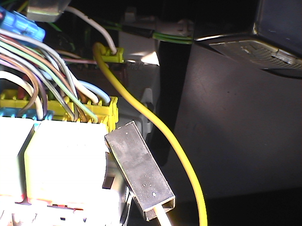

sonofsam 5 Posted October 15, 2006 It may be fused in two places on the fuseboard, mine was. Share this post Link to post Share on other sites

sonofsam 5 Posted October 15, 2006 If it is fused twice you should have a connector like below.Yellow wire 76a i beleive. Share this post Link to post Share on other sites
