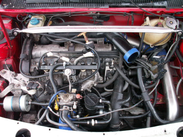

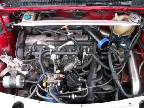

To all: the XM turbo mount does not fit....the engine is misaligned then....on the XM turbo you put an Mi16 topmount to fit it to a 205 etc.
Wrong install (modified XM turbo mount):
Correct install (Mi16 top mount):
