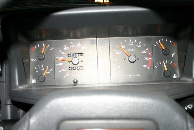

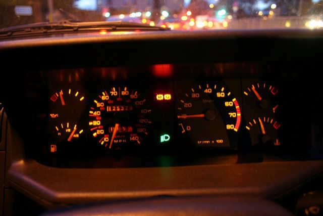

pug_ham 245 3 Cars Posted July 13, 2006 See attached pictures for normal operating temps at idle & whilst revving slightly. These are from a taken from a 205 GTi but the 309 GTi shoud be almost the same. Graham. Share this post Link to post Share on other sites

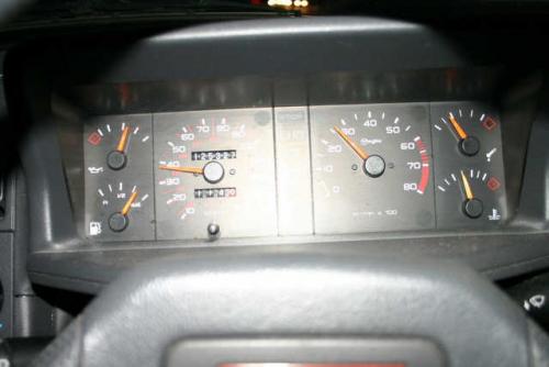

inferno 1 Posted July 14, 2006 well heres the clocks on my gti, with the fans working in slow speed... and revving slightly, seems a bit warm to me, but doesnt overheat or idle rough so im leaving it alone! Share this post Link to post Share on other sites
Henry Yorke 269 3 Cars Posted July 14, 2006 Mine look like Infernos, but my oil temp does not get as high (due to alloy finned sump) and the oil pressure is about the same (lower than standard due to having to pump the oil through the turbo and it has had new shells) Share this post Link to post Share on other sites
pug_ham 245 3 Cars Posted July 14, 2006 well heres the clocks on my gti, with the fans working in slow speed... and revving slightly, seems a bit warm to me, but doesnt overheat or idle rough so im leaving it alone!Thats fine imo, my low speed fan comes on at a higher indicated guage temp than that. Graham. Share this post Link to post Share on other sites

inferno 1 Posted July 15, 2006 (edited) oil temps up as id just given it a hiding normally sits on the second bar. turbos run higher oil pressure IIRC, my zx used to sit at around 4-6 bar, and go up to 8 when cold. Graham, that seems rather high!one more bar on mines almost in the red... :s Edited July 15, 2006 by inferno Share this post Link to post Share on other sites
