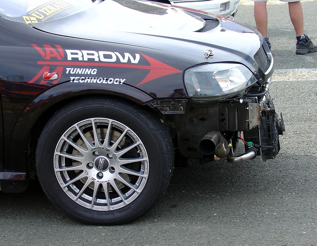

cybernck 403 1 Cars Posted June 13, 2006 how about something like this? Share this post Link to post Share on other sites
