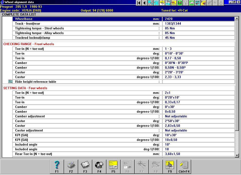

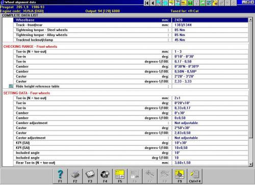

cybernck 403 1 Cars Posted June 12, 2006 maybe a bit late, but here you go... from autodata: Share this post Link to post Share on other sites
