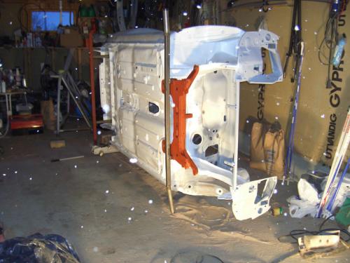

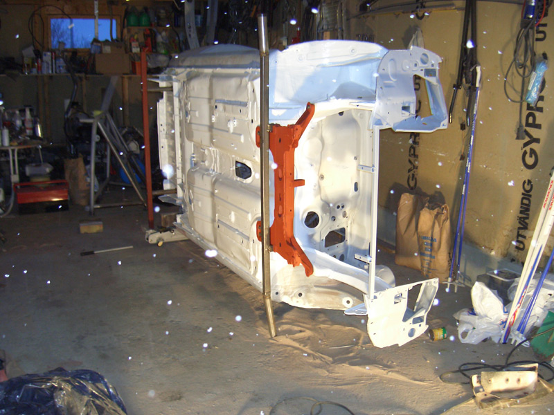

Rik 0 Posted May 22, 2006 There called SPITS like what you see the chickens in Morrisons spinning round on. www.frost.co.uk sell them (not cheap) or you can make your own, i'm making one at the moment, but its just to put the car on its side, what i've done is welded a 'T' piece to a spare subframe for the front, an 'n' shaped piece of metal for the seatbelt mounting point and a sort of metal tripod to place the rear part of the chassis on. Its hard to explain.... BlackMi16 has piccys of his on its side using a similar method but using only the seatbelt mounting point, with leaving the wheels in situ. Rik Share this post Link to post Share on other sites
B1ack_Mi16 67 Posted May 22, 2006 BlackMi16 has piccys of his on its side using a similar method but using only the seatbelt mounting point, with leaving the wheels in situ. I did some modifications to it later, so I didn't have to have the wheels there. Share this post Link to post Share on other sites

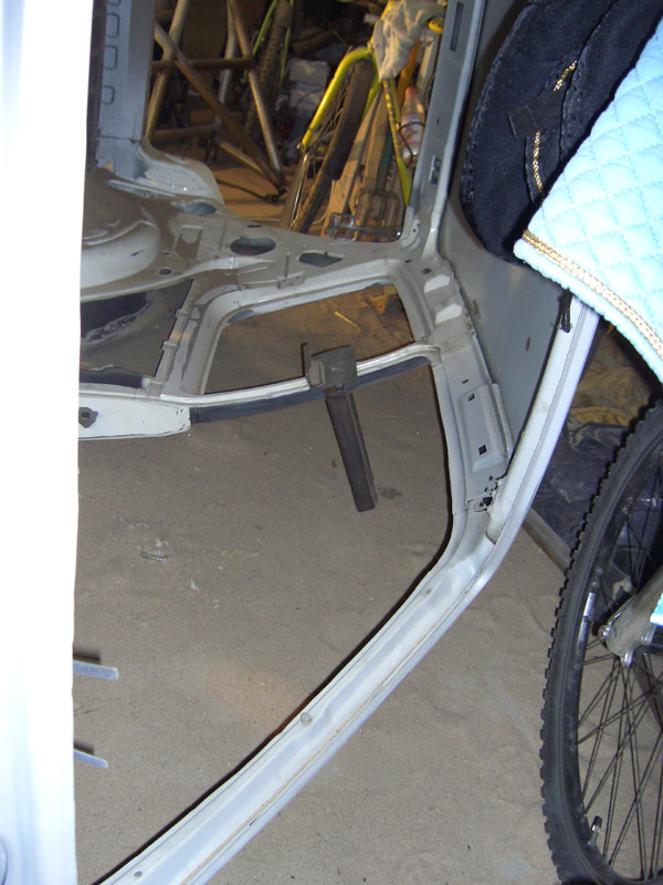

Rik 0 Posted May 23, 2006 Thats pretty much what i've done Blackmi16! do you have any closer pics of the back of the car? whats the jack for? Share this post Link to post Share on other sites
B1ack_Mi16 67 Posted May 23, 2006 Thats pretty much what i've done Blackmi16! do you have any closer pics of the back of the car? whats the jack for? The jack is not doing anything, not sure why it's there in the pic At the rear I just bolted the bar to the rear beam mounts (where the rubbers usually sit) a little bit dodgy, but worked ok because the car ain't heavy at the back. Share this post Link to post Share on other sites
