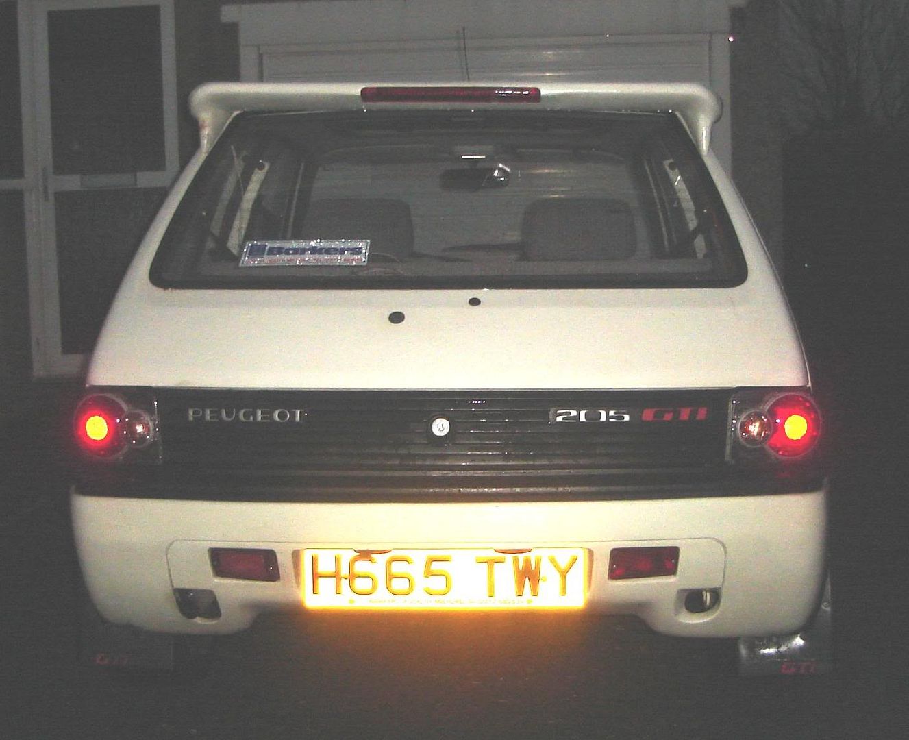

paul205mi16
ben205 any more pics of that rear bumper?is it a one off?
Cheers m8
Paul.

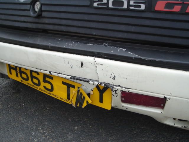

Guest ben205
Cheers m8
Paul.
Yeah mate here you go.... this is before been rear-ended....
http://i79.photobucket.com/albums/j149/ben...PipaPics001.jpg
And heres now, really no good though...
http://i79.photobucket.com/albums/j149/ben...ebaypics030.jpg
For all i know they could be a one off because i have never seen any sideskirts or rear bumper like mine before, ever. i bought them off ebay, wernt cheap but theyre good quality.
