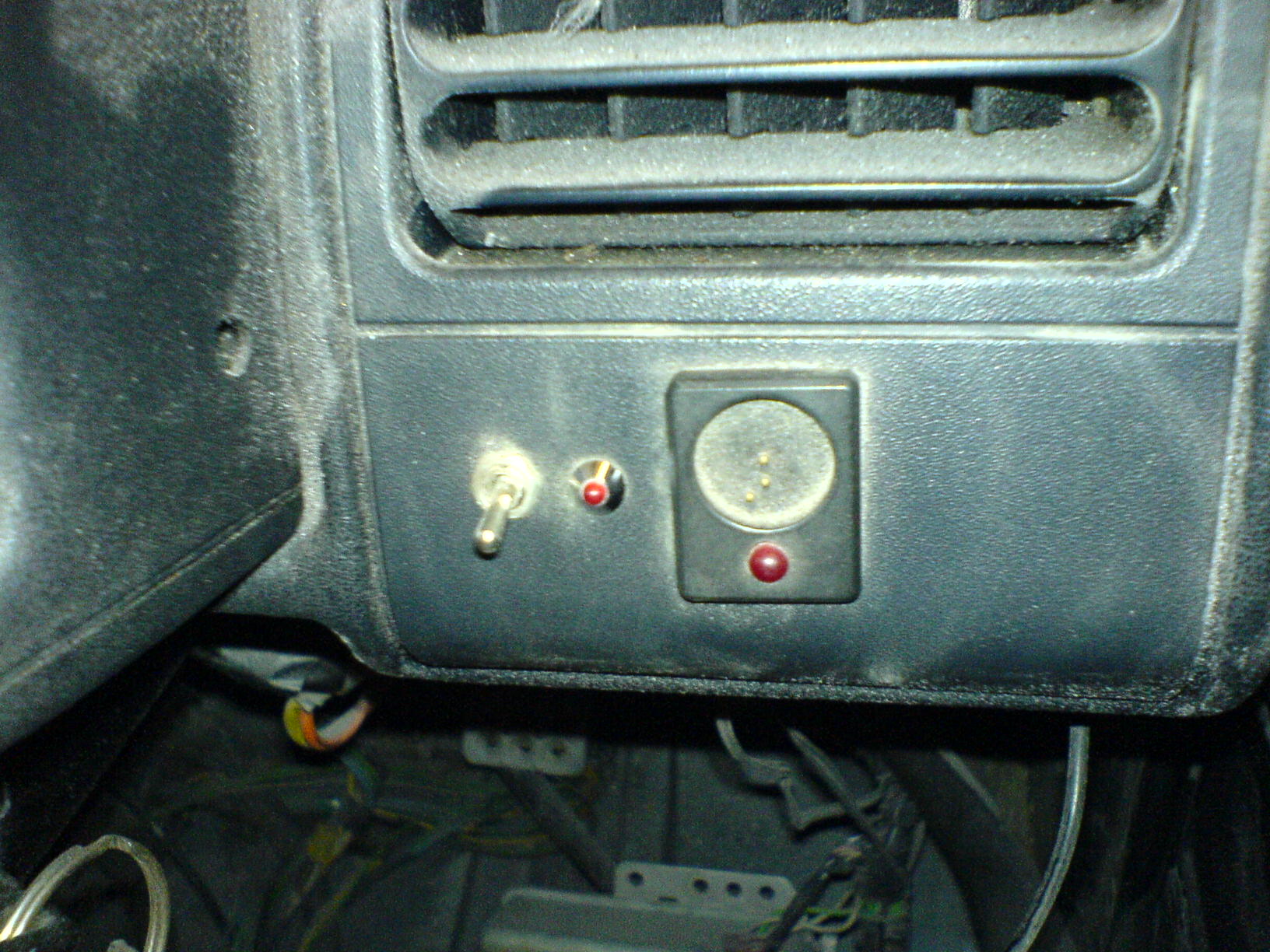

Pugnut
instead of wiring the k light into its proper place you could wire it to an led and wire mini toggle switch into it so that you can even interrogate the ecu's fault codes at any time .
d-9
be good to know how you wired that up (im too lazy to search tonight).
