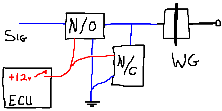

Ok, someone's offered to give me a couple of 12v solenoids and, never the one to make things easy, I'm gonna have a crack at making my own boost control arrangement.
The blue bits are the signal piping to the wastegate, the boxed labeled N/O and N/C are the solenoids which are Normally/Open and Normally/Closed respectively. The thing on the right is the wastegate and then the ECU gets to switch 12v on and off as it sees fit.
SO! With no voltage, the signal can get to the wastegate as it normally would giving rise to my 0.5ish bar of boost as dictated by the settings of the wastegates. However, because the ECU knows the inlet pressure and knows that under certain situations, we want more boost, it can switch the solenoids on so that the one on the left closes and stops the signal from reaching the wastegate, and the one on the right opens so that any air trapped in the wastegate can escape.
Thing the escape solenoid might be important if the wastegate had been open the the ECU cuts it's signal, although I'd probably put a restrictor in the outlet from the escape solenoid to prevent the sudden pressure drop from slamming the gate shut.
Any thoughts guys? :lol:
