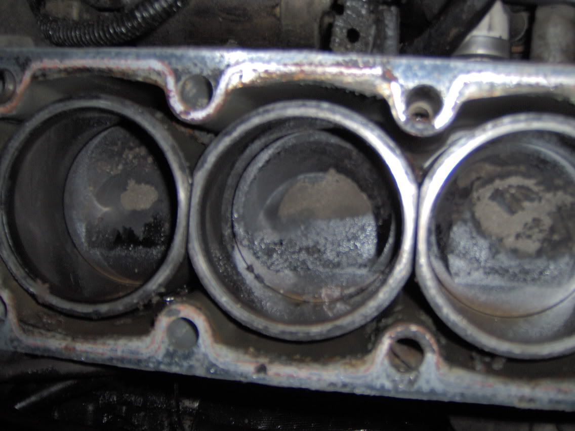

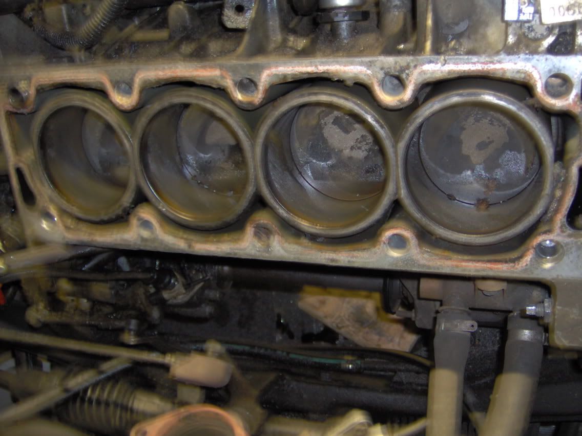

Finally got some time to start this.
Got the head off today & this is what's inside.
Is the cream coloured deposit (like limescale) normal at 108k miles.

puginfo
>>> notice that on the head side the flat section (squish area) appears on the inlet side whilst on the bottom end, atop the pistons, the squish area is on the exhaust side.
i do not see how this could be good match, any reasons for this?
Guest rick03054
They're not.
They're both on the exhaust side. Note the position of the spark plug.
puginfo
>>> what i meant was, the flat sides of the pistons and the combustion chamber does not match. the flat side of the combustion chamber appears on the inlet side (opposite of the plug) but the flat side on the piston crown is on the exhaust side. why is that?
jack biscuit
i'm sure i'm missing the point here but.. pistons wrong way around?
I wet my pants the first time i opened up an XU just a few weeks ago and i made a classic newbie post, which way around should my pistons be..
Being a little ignorant, i assumed 'dist' on the crown meant distributor side.. in my lump it's flat to flat chief..
have a look..
Edited by jack biscuit
Guest rick03054
But the flat side of the combustion chamber is on the exhaust side too. The spark plug is on the inlet side.
