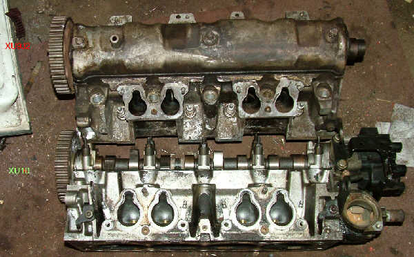

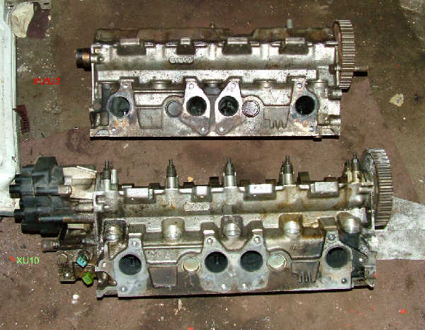

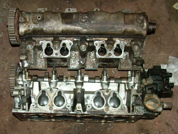

Some pictures for comparison of the XU9J2 & XU10 heads attached.
I measured the inlet ports on each earlier with some digital vernier calipers;
  • XU9J2 inlet = 31mm
    Exhaust = 32mm
  • XU10 inlet = 34.9mm
    Exhaust = 33.5mm
Each measurement was made at the manifold face of the head.
On the XU9J2 head the head to manifold face is cut at an angle for the inlet manifold face where the XU10's are vertical just like the XU9JA head.
Graham.

excellent work Graham! so seems the ports are not that small after all. I'm definitely going to give it a go. thanks
