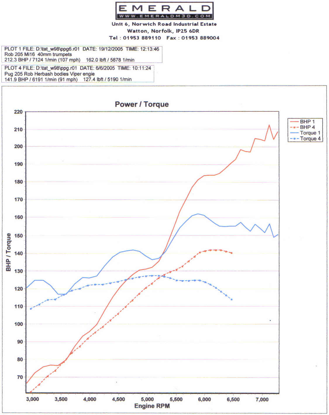

Here's a graph of my current Mi16 on bodies forged pistons, Maniflow 4-2-1 manifold & BV head compared to my old 8v SBC 1.9GTI-S (cams & headwork).
The spikey bit at the end of the Mi16 power figure is due to noise interference.

Thats a pretty impressive result Jeram, didn't realise it was that good!
Does the blue line show the same engine without the carbs, or just without the cam swing?
