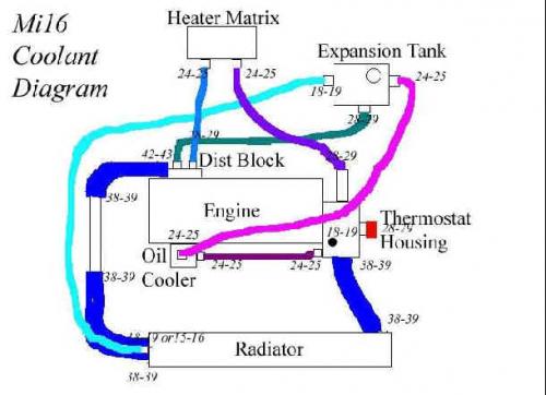

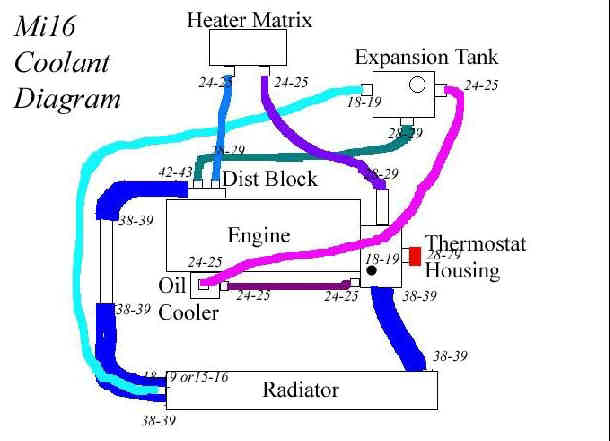

huxley309 0 Posted March 26, 2006 Anyone have any diagrams for the cooling setup for putting an mi into a 205/309? I know pretty much what goes where but if i come unstuck it's good to know i have something to fall back on thanks Share this post Link to post Share on other sites
pacey205 2 Posted March 26, 2006 Not sure on the PAS but this is how my cooling system is setup (keeping the Mi oil/water heat exchanger). Thats using the BX bottom hose for the oil/water exchange rather than the T-top hose. HTH Michael Share this post Link to post Share on other sites
pug_ham 245 3 Cars Posted March 26, 2006 See attached for another cooling into a 205 if you are still going to use the block mounted oil /water heat exchanger. Graham. Share this post Link to post Share on other sites
huxley309 0 Posted March 26, 2006 I think both diagrams are close...mine was slightly different...more of a mix of the two well at least im headed in the right direction Im sure on the oil cooler both pipes came from the rad/therostat housing pipe like the 8v Now all i need is the pas diagram hmm.... Share this post Link to post Share on other sites
pug_ham 245 3 Cars Posted March 26, 2006 Im sure on the oil cooler both pipes came from the rad/therostat housing pipe like the 8vOn the 309 GTi thats how they are plumbed in (I'm sure Anthony & I mentioned this to you earlier this week? )but not the 205 so you can use that & just blank off the one pipe on the thermostat housing like in the diagram I posted. Graham. Share this post Link to post Share on other sites
huxley309 0 Posted March 26, 2006 Aah now that does ring a bell!! Yes on my old mi conversion the side pipe on the thermo housing was blanked off coolio now wheres that pas hmm Share this post Link to post Share on other sites
