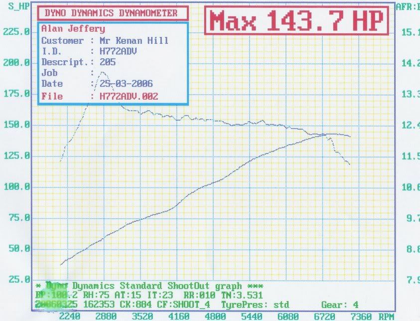

kenan 0 Posted March 25, 2006 Just been to a rolling road and my standard MI gave 144BHP @ the fly. Would be interestd to find out what other people have got from thir car. Mines got an air filter and full stainless exhaust. So tell my your figures...... Share this post Link to post Share on other sites
Jonmurgie 2 Posted March 26, 2006 Blimey, you sure that's @ the Fly cause that's about 20/25bhp down on what it should be... where did you get it RR'd? I had my Mi dyno'd at 170bhp @ Fly with ITG Filter and 4-2-1 Manifold with single backbox (that was on the PowerStation dyno). Share this post Link to post Share on other sites
Rom 0 Posted March 26, 2006 Blimey, you sure that's @ the Fly cause that's about 20/25bhp down on what it should be... where did you get it RR'd? I had my Mi dyno'd at 170bhp @ Fly with ITG Filter and 4-2-1 Manifold with single backbox (that was on the PowerStation dyno). Ive not had mine on the rollers yet. Did the operator give u any pointers as to where ur losing power ? Its not uncommon for worn engines to be down on power. But that seems quite a lot. Share this post Link to post Share on other sites

Ahl 4 Posted March 26, 2006 Hengti is right, RR's are notorious for different power figures, but the problem is that its not a tuning process, hes just had a power figure taken. Without any before or after figures to compare it to then he'll want it to mean something. What was the wheel figure they gave you? On an accurate rolling road a healthy 1.9 mi should put out at least 134bhp at the wheels. (approx 160hp fly) Share this post Link to post Share on other sites

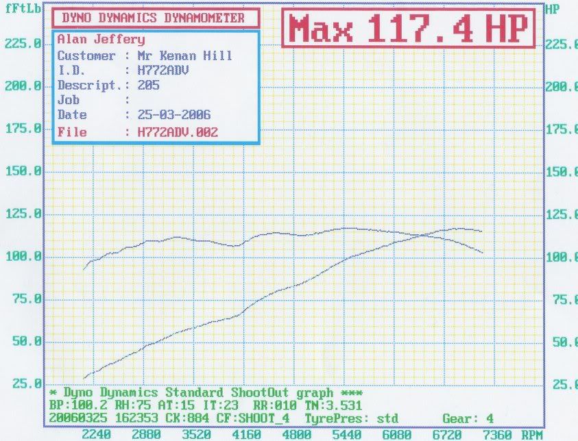

kenan 0 Posted March 26, 2006 WEll I was firstly after other people dyno results. My engine was rebuilt just over 12K ago so not old etc and the rollers seemd spot on. A GTI 180 got 166, an Astra GSI put in 150 on the dot (Book figures) and a standard 106 GTI put in 134 (Good result for standard) and a 206 GTI put in 140. All in all the rollers seemed fine to me and they are a good set being Dyno Dynamics. After my results the car started miss firing and found water in teh spark plug holes (about 1cm+ deep), which I am hoping was causing the car to not produce the correct spark etc. Either way not happy with the power results, see below: Flywheel Power Wheel Power + Torque Share this post Link to post Share on other sites
