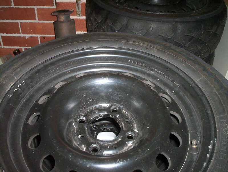

Citroen C5 black wheels - 4.8Kg. They mighten be pretty, but they're light!
Ahl
Which wheels are those peter? I always try to work it out but I can't pinpoint the right ones. Some ugly lightweight wheels could be handy. ;)
Just find a base C5 with a dress rim, not a full alloy wheel. There's heaps of them.

Graham.
Leon C
I bought them from the local Citroen dealer. All C5 wheels are aluminium.
They look ideal!
How much did you pay for them?
Did you use the standard 15" 205 Gti wheel bolts, or C5 ones?
Looking at the picture Peter attached they look like they have a taper seat so the standard GTi bolts won't work.
You'd need some from either a 205 that had steel wheels or a C5. (or better still a stud conversion & some spare taper seat nuts. :P)
Graham.
KRISKARRERA
The tapered bolts from other Pugs with steel wheels would fit.
