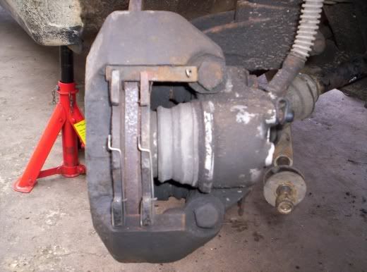

You mean Bendix or Lucas-Girling.
Just had a look at the ones on my 1.4, on the back of the caliper if you clean immediately below the bleed nipple they have Bendix in raised lettering if they're made by Bendix.
If you like i can take some pics from various angles if you need. I think i identified my with the haynes manual originally as i recall.

Get some gti6 or 307 brakes :) standard 1.4 stuff's pretty pants, prob the same as u have now. Heres a few pics anyway:
front
side
back
You should be able to just about make out the writing on the back of the caliper in the third pic.
