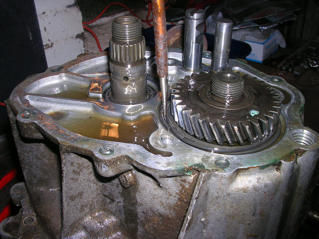

SPGTi 2 Posted March 19, 2006 Thanks for the replies. Also thanks to Alex205Mi16 and Adam young for the free gearboxes to raid for parts. Here is the step by step article on changing the CWP CHANGING CWP. Maybe the author would allow this to go on the main site ? Any more opinions ideas etc gratefully received. Steve Share this post Link to post Share on other sites
Paintguy 0 Posted March 19, 2006 Chris, I think this picture might have come in handy when we were trying to strip yours Definately worth contacting the author I reckon. That'd be a handy article to have on the main site. Share this post Link to post Share on other sites

309PUG 2 1 Cars Posted March 19, 2006 Chris, I think this picture might have come in handy when we were trying to strip yours Definately worth contacting the author I reckon. That'd be a handy article to have on the main site. Yep, this article I found would have seriously helped, never mind. Chris Share this post Link to post Share on other sites
