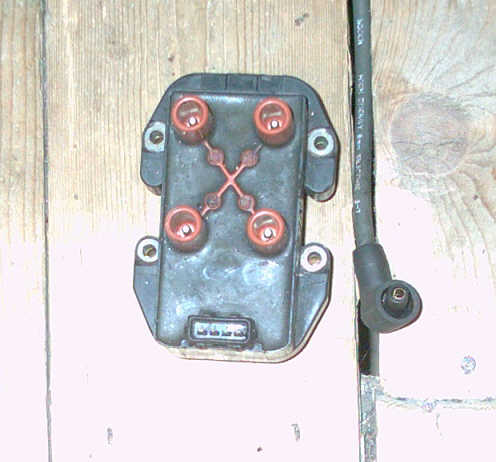

  309PUG said:
The coil pack came with my DTA kit, they say it is std Peugeot / Citroen, holes are 18mm dia, with a recessed pin in the middle about 3.5mm dia, the connecting plug is 4 pin rectangular in shape.
Thats sounds to be a bit to big for a Pug or Citroen coilpack, my coilpack ends are 15.15mm wide on my verniers but otherwise it sounds OK & I'm sure teh rubber boots will stretch out.
I've attached a picture of the coilpack & lead end for comparison.
I think the ideal off the shelf set of leads for your car would be those for a 1994 205 1.6 Automatic. My mum has one & the leads are exactly the same as mine which I got from a ZX 1.6 in the scrapyard.
Magnecore should be able to find the exact length of these & make a set suitable, if not a trip to a scarpyard in Sheffield. I could measure a set I have if you want Chris.
