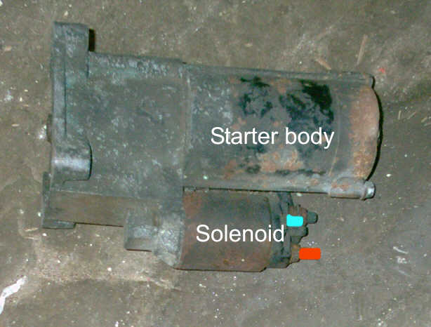

pug_ham 245 3 Cars Posted March 6, 2006 Starter should be two cylindrical bodies joined in a piggy back style. See attached photo for what colour wire goes where. Red is main battery feed & Blue is ignition switched solenoid wire. Graham. Share this post Link to post Share on other sites
Anthony 1,003 Posted March 6, 2006 That is possibly the grottiest looking starter motor ever there Graham! Share this post Link to post Share on other sites
pug_ham 245 3 Cars Posted March 6, 2006 That is possibly the grottiest looking starter motor ever there Graham! Its an old spare, not even sure if it works. Perfectly suitable for this use though. Graham. Share this post Link to post Share on other sites
Guest Quakes Posted March 6, 2006 yep thats how my wiring is :/ still when i connect the battery it just keeps turning the engine over grrr i really should of put it in a garage lol Share this post Link to post Share on other sites
