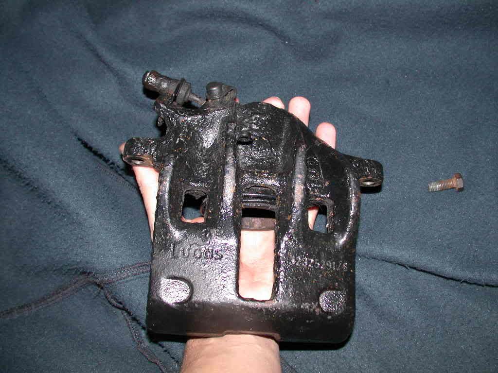

Dixon 1 Posted March 5, 2006 Quick pic for reference... http://i25.photobucket.com/albums/c67/alan...05/DSCN7730.jpg In that pic the bolt is through the bottom hole and the top is pushed as far in as poss and as you can see the hole isn't even close! Share this post Link to post Share on other sites

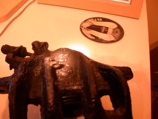

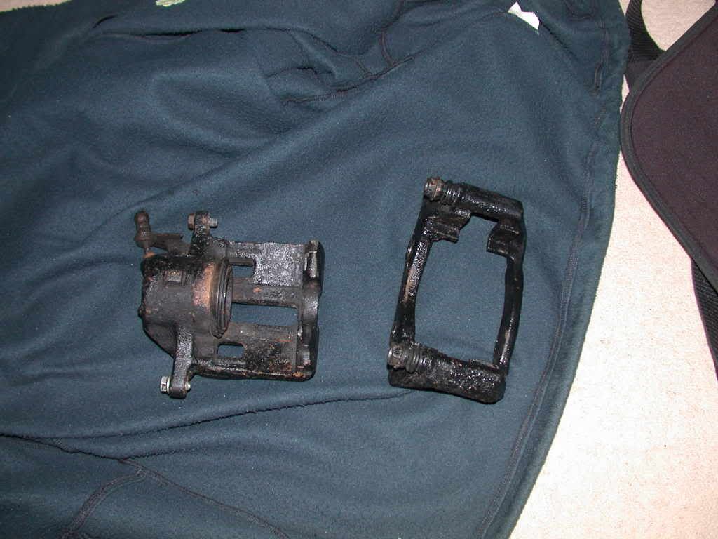

Dixon 1 Posted March 5, 2006 Couple of pics of the parts... http://i25.photobucket.com/albums/c67/alan...05/DSCN7738.jpg http://i25.photobucket.com/albums/c67/alan...05/DSCN7739.jpg http://i25.photobucket.com/albums/c67/alan...05/DSCN7744.jpg Anybody recognise them? Share this post Link to post Share on other sites

Hilgie 16 2 Cars Posted March 5, 2006 The calipers look like 266 items because they lack the cooling ribs on the rear of the caliper that the 57mm GTi6 ones do have. Can you see if there's anything written on the caliper? They should have 57 on them somewhere. If not it will be 54 items. Share this post Link to post Share on other sites

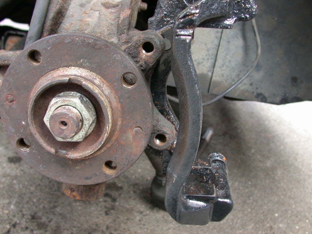

Dixon 1 Posted March 5, 2006 Its definatly got the number 57 cast into the main calliper part as you can just about see is these 2 pics... http://i25.photobucket.com/albums/c67/alan...05/DSCN7748.jpg http://i25.photobucket.com/albums/c67/alan...05/DSCN7764.jpg To get it to fit on the hub it would require shaving here... http://i25.photobucket.com/albums/c67/alan...5/DSCN7771a.jpg But even if I could get it on the hub i'm not sure if the disc will fit beneth it, i'll have another look after work tomorrow and hold it all in place and take some pics. Can other carriers fit with the '6 callipers? Share this post Link to post Share on other sites

Anthony 1,003 Posted March 6, 2006 Those look like 406 283mm brakes to me, which don't fit 205 hubs as you've discovered... Share this post Link to post Share on other sites

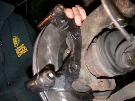

Dixon 1 Posted March 6, 2006 Took some pics of it held to the car with the disc on... Its not deep enough to accomodate the disc as it doesn't even reach the hub when the disc is on, bit hard to see with my poor photography though! http://i25.photobucket.com/albums/c67/alan...05/DSCN7777.jpg http://i25.photobucket.com/albums/c67/alan...05/DSCN7781.jpg http://i25.photobucket.com/albums/c67/alan...05/DSCN7779.jpg Are there any ways of telling if they are 406 brakes? What cars are they likely to fit, am I likely to be able to sell them to anyone? Or am I going to have to pay the guy I bought them from a visit to get my money back?! Share this post Link to post Share on other sites
