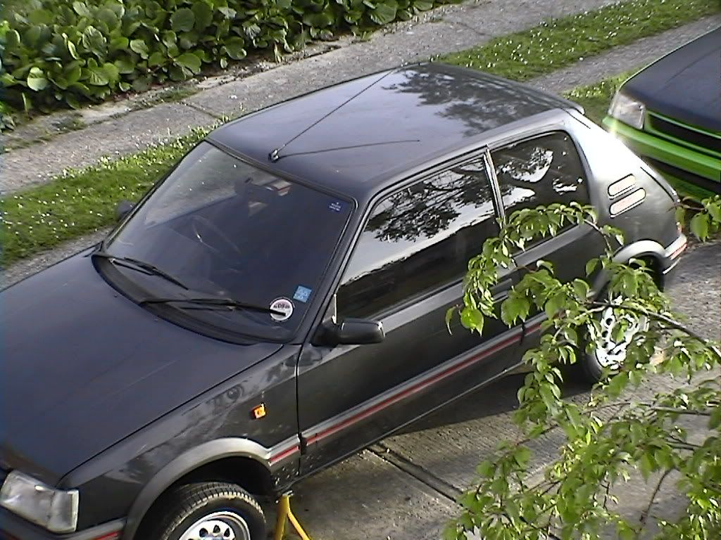

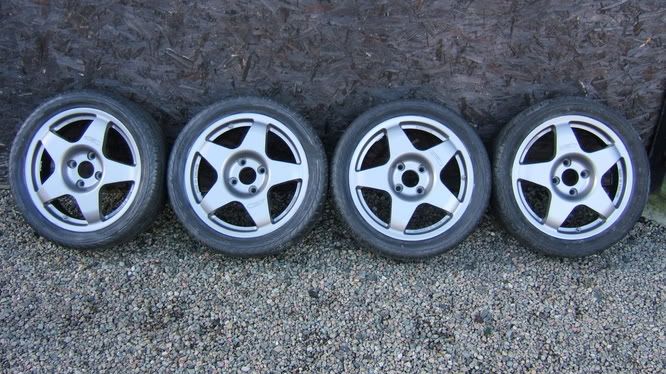

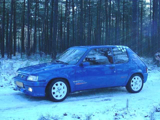

sonofsam 5 Posted February 14, 2006 Cheers lads.. ill have a play this weekend. Got a top engine mount off a 2.0 16v citroen engine ( no idea from what car as the engine was "off the shelf" at a breakers yard. Looks about right though sonofsam, what intercooler is that ? U got any pics of your actual pug. From seeing ur previous posts, it should like it will be similar to mine.. Mines white and decaled up with t16 graphics Think the IC came from a Fiesta RS,im not using it anymore , my 205 looks like this at the moment albeit the arches,will end up looking like this one with some different rims in white ...No doubt i'll have a few decals on there though How is your conversion coming along?Thought you had a 306 xsi top mount sorted.Can you put a picture up of the 16v citroen mount,Ta Sam. Share this post Link to post Share on other sites
