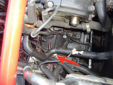

my mi16 gearbox didn't appear to have a bolt or anything on it for the earth strap from the battery to attach to and now taht the engine's in its really hard to see where it should go as there are loads of different holes along the edge of the box. and i cant find one to put a bolt in
If anyones got a picture that would be great also any idea about bolt diameter

any of them will do mate, there certainly should be some where the pas pump attaches, connect it to that.
the proper earth point is in the same place as on the 205 box.

just in front of the PAS pump on mine mate.

Do all 205's use this earth point? My battery is earth'd through the bolt on the inner wing :D
Yes but it should also have an earth lead that goes to the gearbox stud (arrowed in attached picture).

Cheers pugtorque. i think i had mine so that earth was going to the power distribution box thing., thanks for clarifying!
