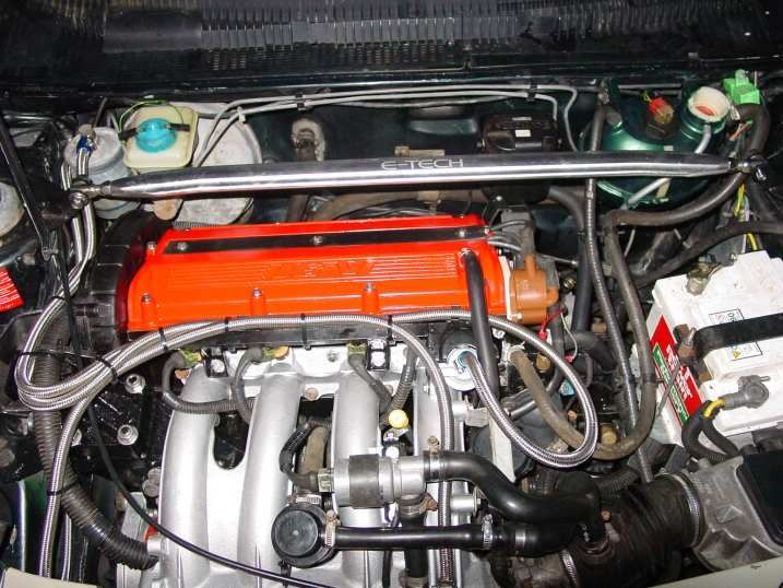

kenan 0 Posted February 6, 2006 Can anyone give a rough estimate on how much a decent garage would charge for fitting an Mi16 engine to my 205, currently has a 1.9 BE3 box (which I would intent to keep) - FITTING ONLY There is a guy on here who did it for me. I had an engine supplied, rebuilt etc. Belive the standard charge for fitting only is about £300-£350 and it's a really good job. The usual garage would make a hash of it if you ask me. looks like below: http://img.photobucket.com/albums/v430/ken...ill/my205mi.jpg Share this post Link to post Share on other sites

Simes 248 2 Cars Posted February 6, 2006 There is a guy on here who did it for me. I had an engine supplied, rebuilt etc. Belive the standard charge for fitting only is about £300-£350 and it's a really good job. The usual garage would make a hash of it if you ask me. looks like below: http://img.photobucket.com/albums/v430/ken...ill/my205mi.jpg Same guy did mine. Share this post Link to post Share on other sites
