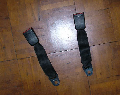

sekim 0 Posted January 11, 2006 Just to add another option... I put the eye bolts into the tunnel just behind the seats and used a pair of 309 front seat buckles. These are longer than the 205 standard ones and straighter. I had to bend them slightly them to get them exactly where I wanted but now they're pretty much ideal imho Pics - sorry about the mess!! http://www.saywell.net/albums/205stuff/dsc00081.sized.jpg Share this post Link to post Share on other sites

MartinM 0 Posted January 12, 2006 MOT man failed my rear seats as they were in-situ (as required by Road Rally regs) but couldn't be secured in the upright position because of the roll cage. He said if I took the seats out, he couldn't fail me on that aspect....but....he would fail me if I came back with the rear seats out but with the rear seat belts still in place (even if fully working) So, out came both, re-passed MOT, back in went both On the original issue, I just took the buckles off the front seats and attached them to the tunnel with the mentioned captive nut plates. IIRC the buckle on the RH seat went on the LH side of the tunnel and vice versa. MOT man inspected the buckles in their new position and never said a word. Now I can use the normal seatbelts going to the shops and the Sabelt 6-points when not going to the shops.... Share this post Link to post Share on other sites
