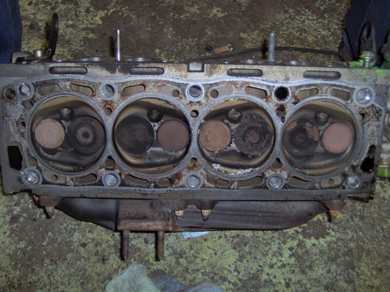

black-mi16 haave you picture of the combustion chamber on the head?

B1ack_Mi16
I wonder if a 306 xsi engine has been turbocharged? and passed off as turbo engine.
lee
Yes, this is the head:
