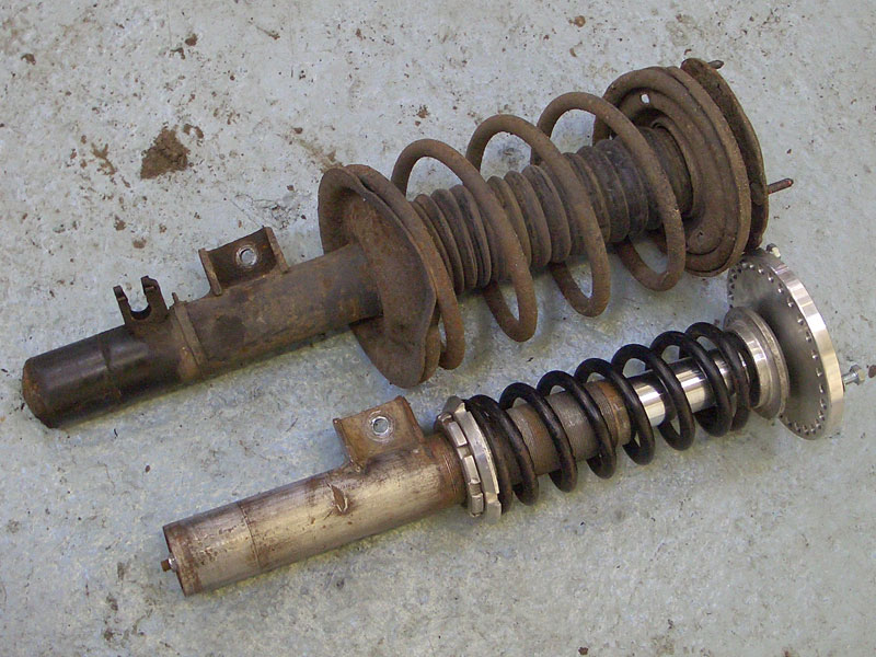

i'm always repeating my question but never get an answer really.
is it possible to use r/j (concentric, not eccentric) top mounts with standard shocks?
as i see it, i need to modify the top spring pan to appear as the top spring pan on a coilover shock.
would that work or not?
check the pic to see what i mean (courtesy of jonmurgie iirc).
alternatively, is that WMMS one meant for use with standard shocks?
thanks.

I'm sure you can use concentric top mounts with standard shocks, for eccentric mounts definetly have to have coilovers.
Give TAS a call,they will tell you straight away.
They look like eccentric top mounts in that picture.
You could probably get an eccentric mount to fit,but you would have to get a top spring pan modified from a coilover kit to fit over a standard diameter piston shock. I can't see any reason why it can't be done, unless someone knows different.
