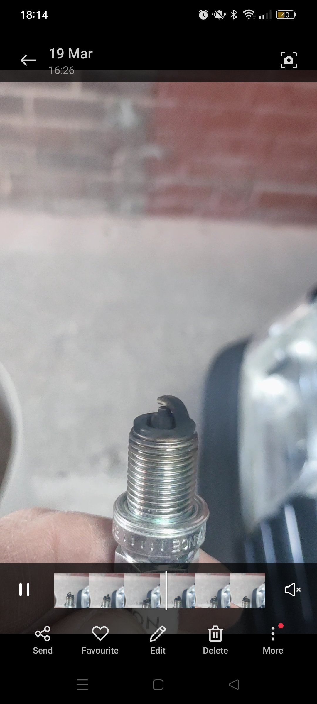

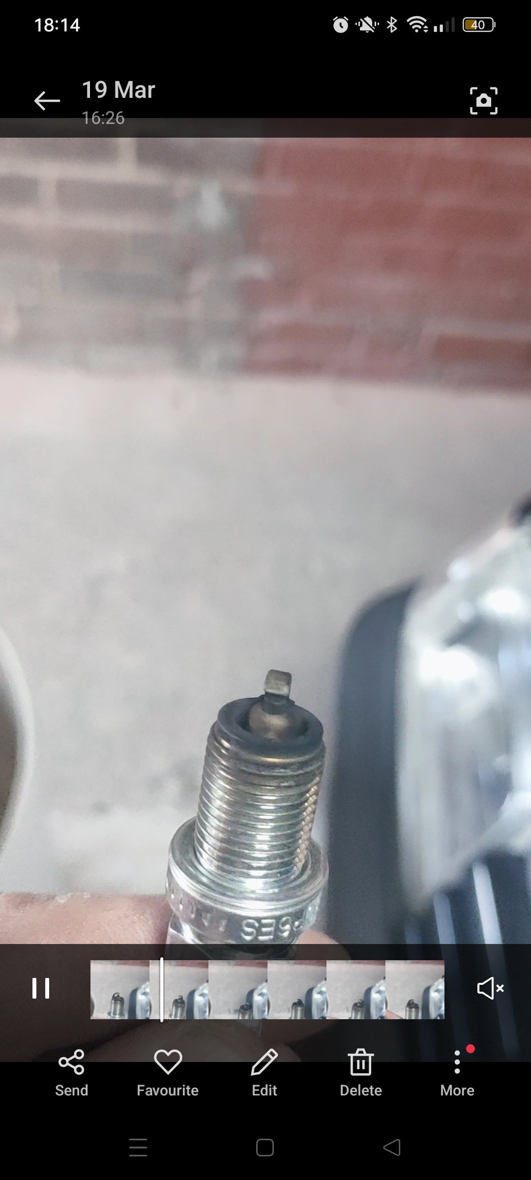

Spark plugs are all black on one side only.

Is it hesitant between 2k and 3k @ wot? Or part throttle? Did they only map the high load cells or also the "zero" load cells in the calibration? Does it run open or closed loop in that part? There are a lot of factors in play, especially with a cammed engine. Cammed engines and map sensors do not always play nice afaik.
Looking at the plugs it appears to run pig rich. What heat range are they?

Hesitant at any throttle range other than steady rpm, all open loop, not been able to get it running well enough to test closed loop. Map readings look fairly steady throughout the range.
Plugs are ngk bcpr6es, tried 7s as well
