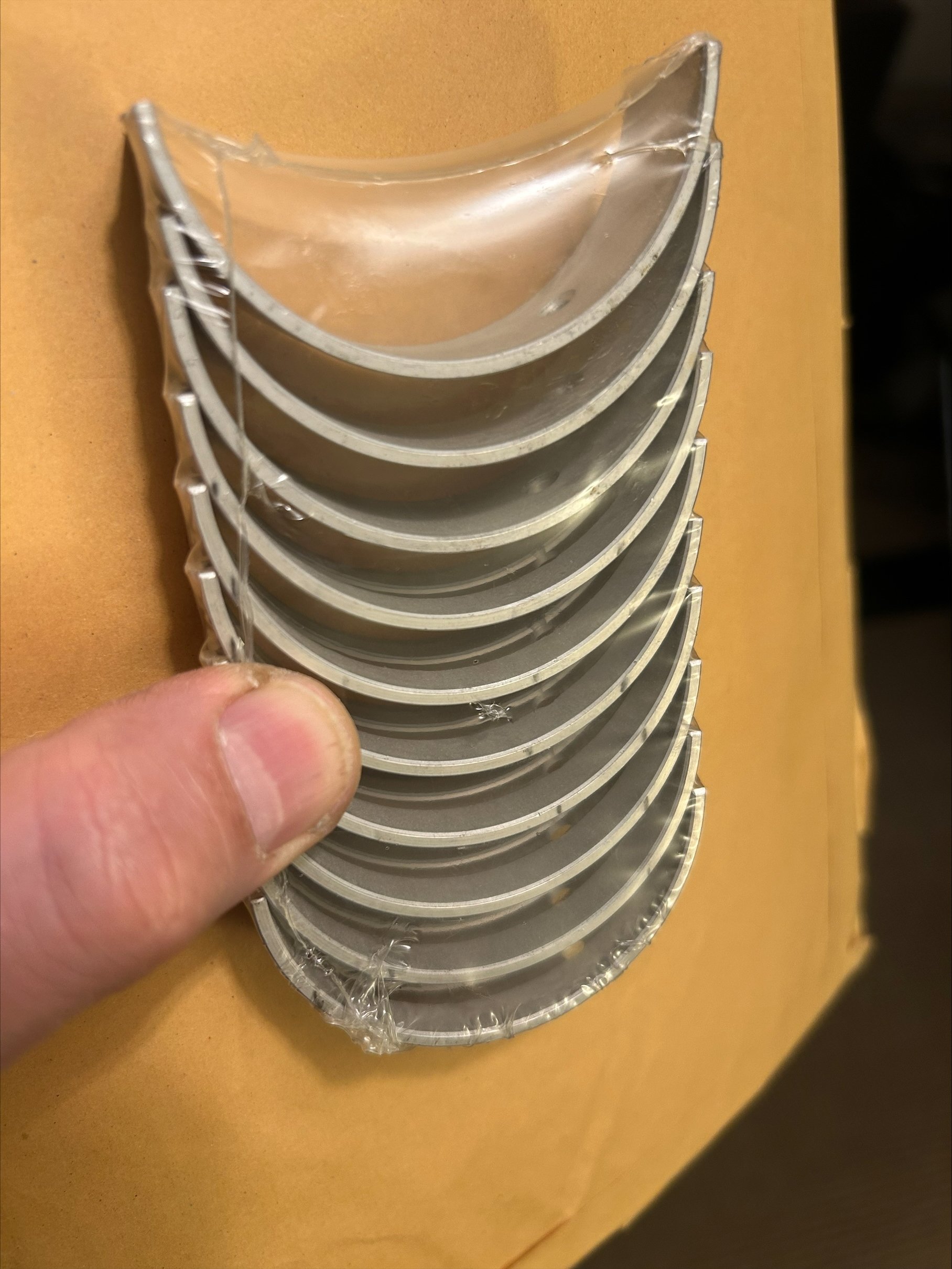

Main bearing shells , grooved and plain .
hoodygoodwood
I had to have my XU9J4 crank main bearing journals ground to 0.5 mm undersize because the engineering company cocked up the 0.3 mm grind . The standard size main bearings  that i removed had 5 grooved and 5 plain shells , the replacement 0.3 mm shells were also 5 and 5 but when i bought a set of 0.5 mm shells ( King ) there was 7 grooved and 3 plain . I spoke to the supplier and returned them then when the replacements arrived they were also 7 grooved and 3 plain . They were all sealed in plastic so were incorrect from the factory , has anybody else had this happen , i can't imagine they are supposed to be like this !
Early engines were like this, 86-87.

I am not an expert by any means, and my engine is still not finished, but I encountered the same problem on my xu5 (one of the first génération, you would have some variation between my block and your newer xu9, but from my understanding, the logic is the same). The conclusion that I had with all the answers on my thread is that there is plenty of variation, but if the oil passages are aligned, you are good.

I have bought another set from a different supplier , the ad specifically says 5 grooved and 5 plain so hopefully they will be fine . Will keep this set for spares . Its been a right performance getting the mains sorted , will be good to get the crank fitted .

On a XU10 there is no longer a standard lower plain shells, you have 4 of them and you must choose the correct ones to get your 0.038-0.069mm of clearance.
That is also true for newer XU5/7/9 with 0.025-0.062mm of clearance.
My take:
The XU9J4 crank only feeds oil to the rods via journals 2 and 4 and only on those journals you could use the groove on both sides to have more continuous oil pressure on the rods.
Later cranks have holes 4 journals, so implicit more flow to the rods.
Note: this is not a proven fact, just an idea!
