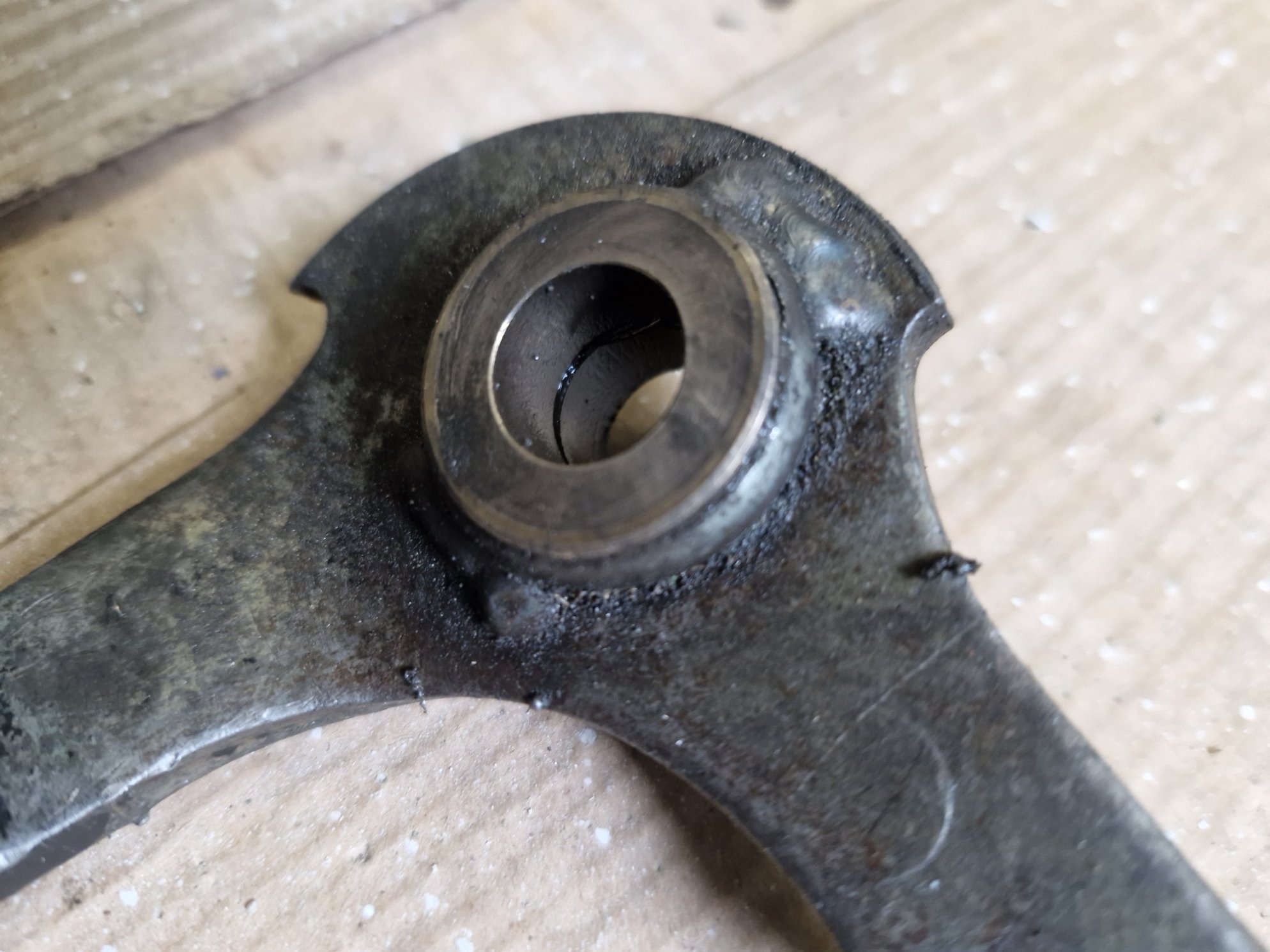

ArthurH 7 Posted February 4 Is this bearing replaceable? Ours has a small amount of play around the shouldered bolt that passes through it, I'm not sure how critical that is the overall gearchange 'feeling' Share this post Link to post Share on other sites
petert 601 Posted February 4 oem was plastic, so yes. Bronze would be good. That looks like steel? 1 Share this post Link to post Share on other sites
Gohn 69 Posted February 4 (edited) baker bm do those I got a set PLUS the gearlink rods PLUS the brass gearstick bushes https://bakerbm.com/product-category/products-for-205-309/gearchange-linkage-products-2/ and Pug Racing may do them too but not sure ..? they used to do the gearlink rods Edited February 4 by Gohn 1 Share this post Link to post Share on other sites
Tom Fenton 1,554 Posted February 4 Those in the photo look like the original plastic ones Its worth getting rid of as much slop as you can There are bronze bushes available although my experience is that most need a small mod of some sort to fit nicely on the shouldered bolt/pin. Easy if you have a lathe but not so easy otherwise. 1 Share this post Link to post Share on other sites
Leslie green 116 Posted February 4 (edited) https://www.ebay.co.uk/itm/293472967220?mkcid=16&mkevt=1&mkrid=711-127632-2357-0&ssspo=EuVmPRkXQV2&sssrc=4429486&ssuid=dwDk9pSjQyO&var=&widget_ver=artemis&media=FB_MSG Saw these above , I replaced mine with new plastic ones and its way too tight now guess they were not quite right , you can get a quickshift from Baker bm also with the bronze bushes in it . Edited February 4 by Leslie green 1 Share this post Link to post Share on other sites
ArthurH 7 Posted February 4 2 hours ago, petert said: oem was plastic, so yes. Bronze would be good. That looks like steel? I think the photo is a little misleading - in 'real life', the bushes are bronze in colour - but I wouldn't be able to tell if that was sintered or phosphor. I'm trying to establish the benefit we will get from replacing them. There is some play between the bushes and the bolt, but what is normal? Share this post Link to post Share on other sites
Leslie green 116 Posted February 4 The plastic ones had a thin spring steel washer on top to allow some movement , if they are bronze already they are probably fine. 1 Share this post Link to post Share on other sites
ArthurH 7 Posted February 4 Thanks Leslie, exactly what I needed to hear Share this post Link to post Share on other sites
