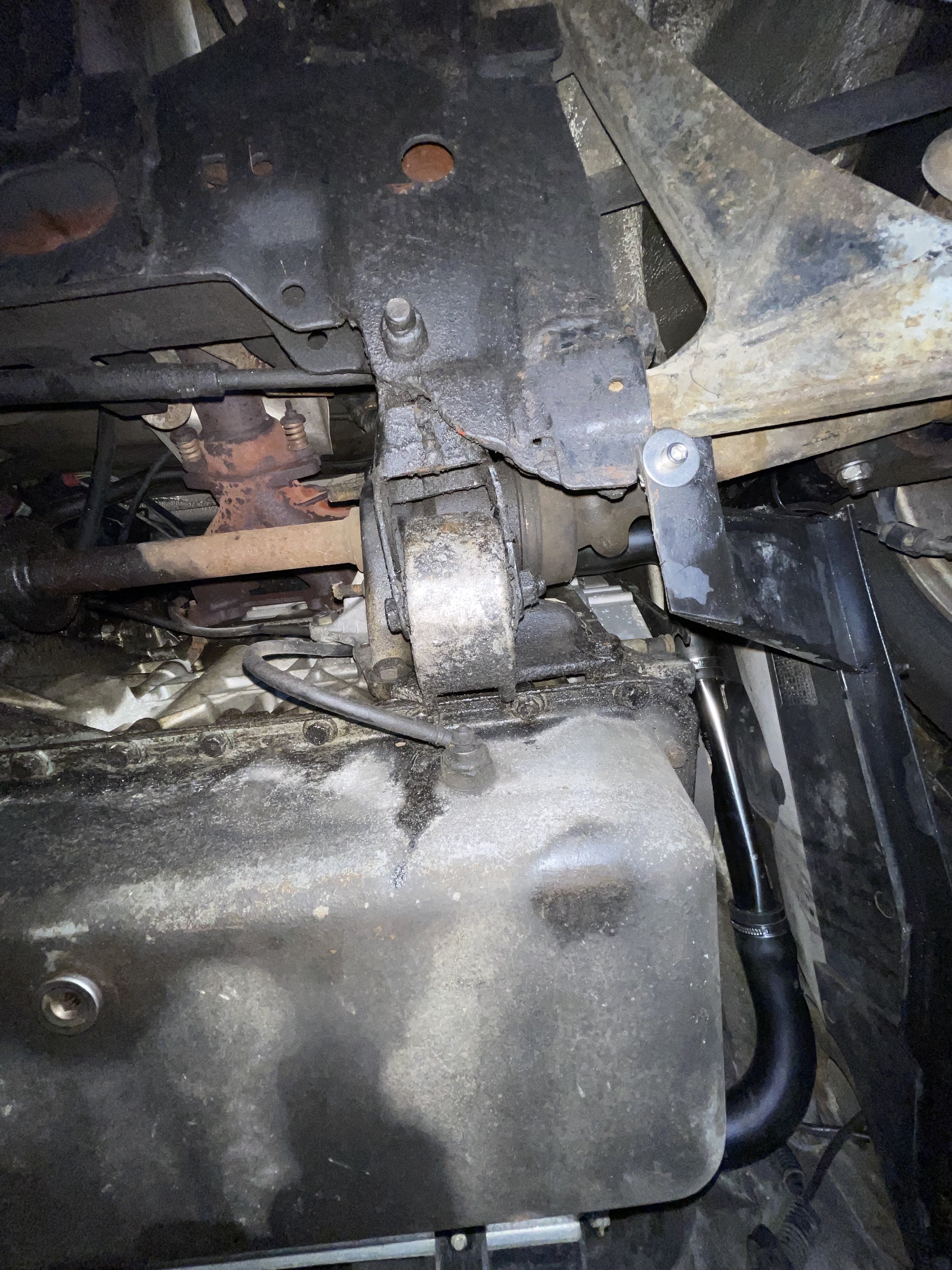

Ive had what felt like an unbalanced wheel but only related  to a certain rev range.  Wheels balanced but was still there. I’ve identified it as a deteriorated lower engine mount which I’m replacing. However the bracket and mounting do not appear to line up. Anyone have any reasons for this that I can correct, maybe? Please see picture below

With a new bush it should be fine ,the centre of the bush hss twised as the rubber is gone.. Make sure the new bush goes in the same as the old one as the position isn't obvious when its off the car and sits at an angle.

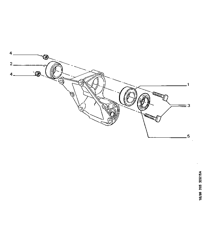

Im not near my car and did it a while back but it looks same as other pics of ones I saw on ebay. The rubber bit on the  drive looks like its of the carrier bearing looking at this pic

That looks quite an angle, is the gearbox mounting ok?   There are two holes in some cases.

looking at the driveshaft again there is no way that rubber boot could get over the wider diameter collar at the steady bearing so it can't be from there and is maybe something fitted to auto's .

I have changed both the upper engine and gearbox mounts. All went in satisfactory but that didn't change the  angle of the lower engine mount. I am minded now to either:
1) bend the bracket so at least the mounting holes in the rubber will be at 90 degrees to the mounting itself. This would pull the engine towards the subframe by a few mm. Or
2) drill 2 new mounting holes and move the bracket across by say 2 cm. This would line every thing up again.
anyone  done anything like this?

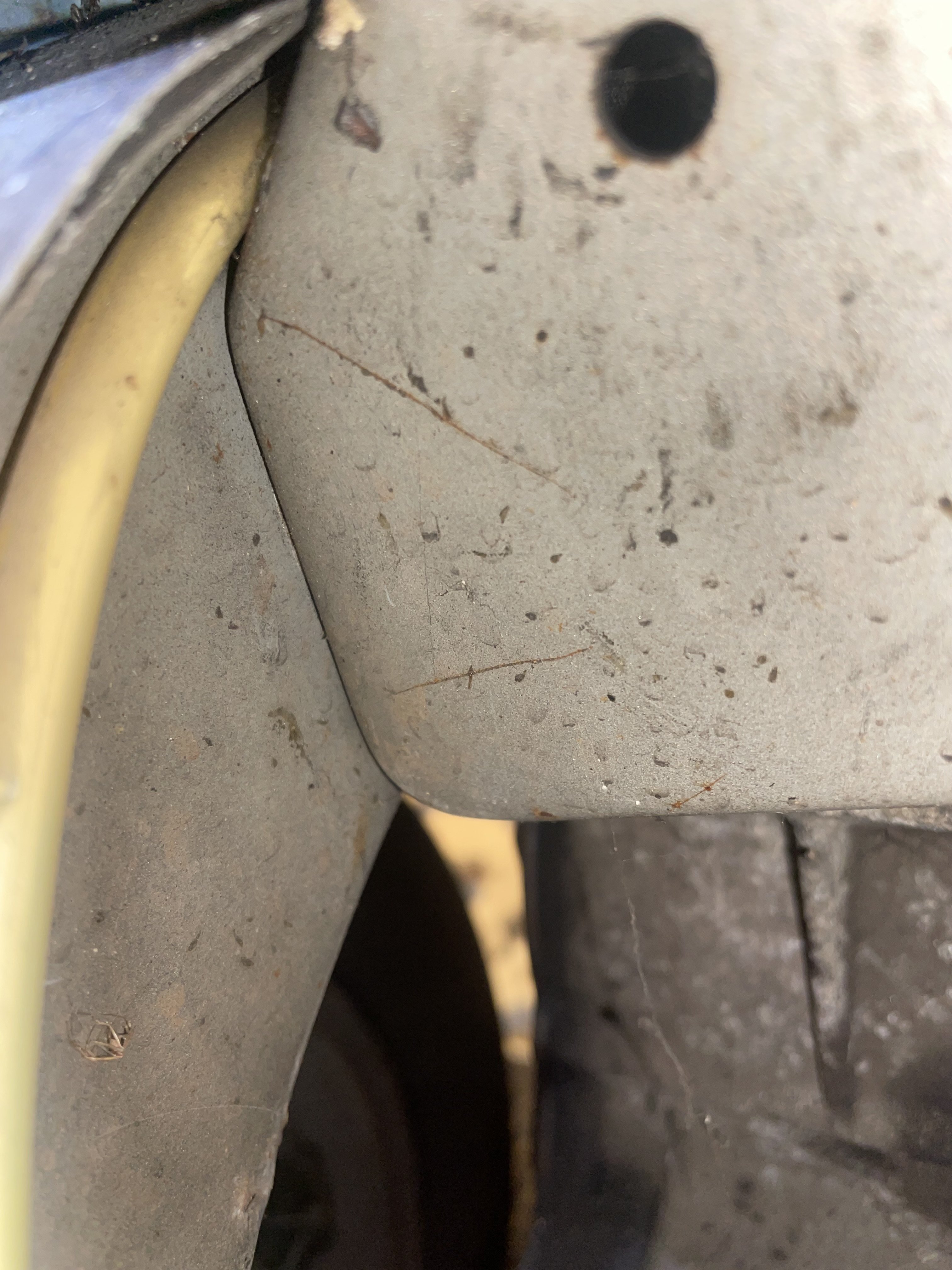

Wow, thanks Leslie, that is a very interesting information ref the 2 vertical and 2 horizontal bolts holding the battery tray. I can not see the horizontal bolts but there is no movement and the tray looks firmly set against the wheelarch area. See photo. I’ve now changed all engine/gearbox mountings and there is very little difference in the angle of that lower mounting bracket. Maybe its an auto gearbox issue cf manual gearbox.
