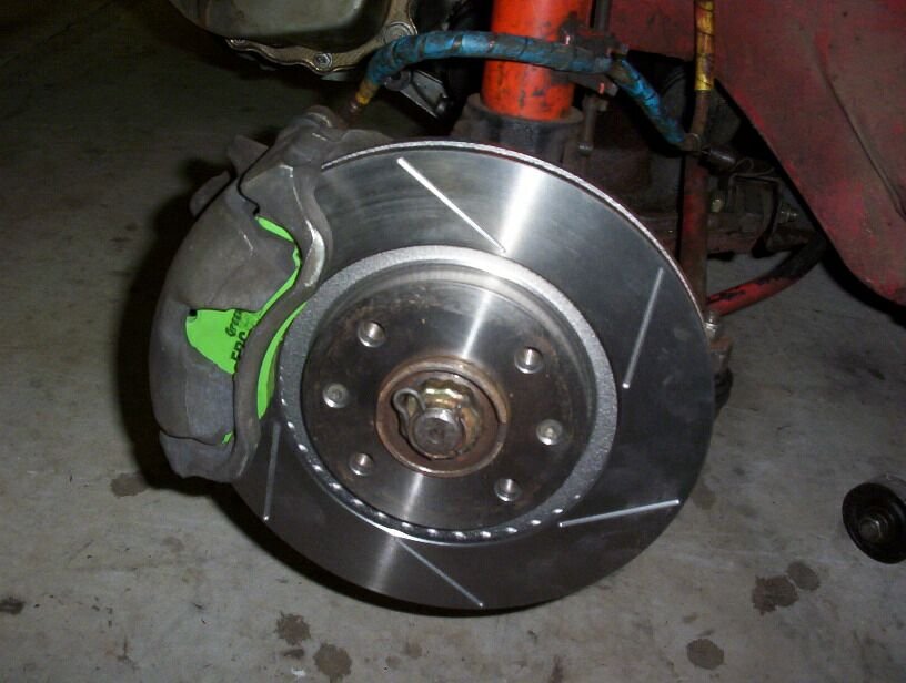

petert 607 Posted November 28, 2024 Here are my Lucas 266mm calipers under 14" Speedlines, with EBC Greens. I recalled that I had to use a 3mm wheel spacer when the pads were new. I wouldn't both messing with the drums. They do bugger all anyway. Share this post Link to post Share on other sites
Gohn 71 Posted November 28, 2024 thanks gents, don't mind staying with the original rear drum setup, quite like it actually but its a bit of a bummer to hear there's no point in getting front disk performance pads for all of these low speed suburban roundabouts ! oh well, sent EBC an enquiry so if there's no reply there's no alterations necessary Share this post Link to post Share on other sites
