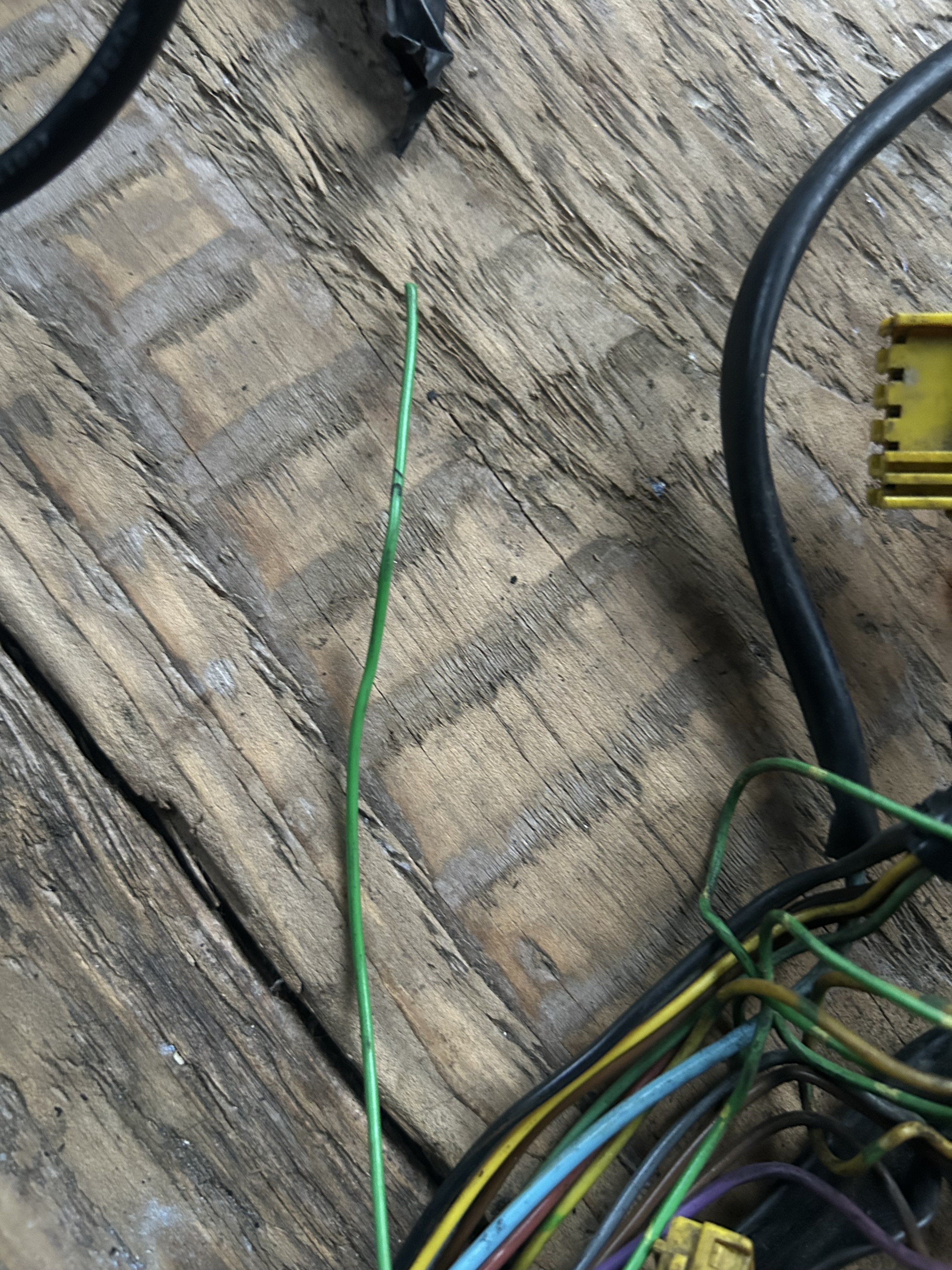

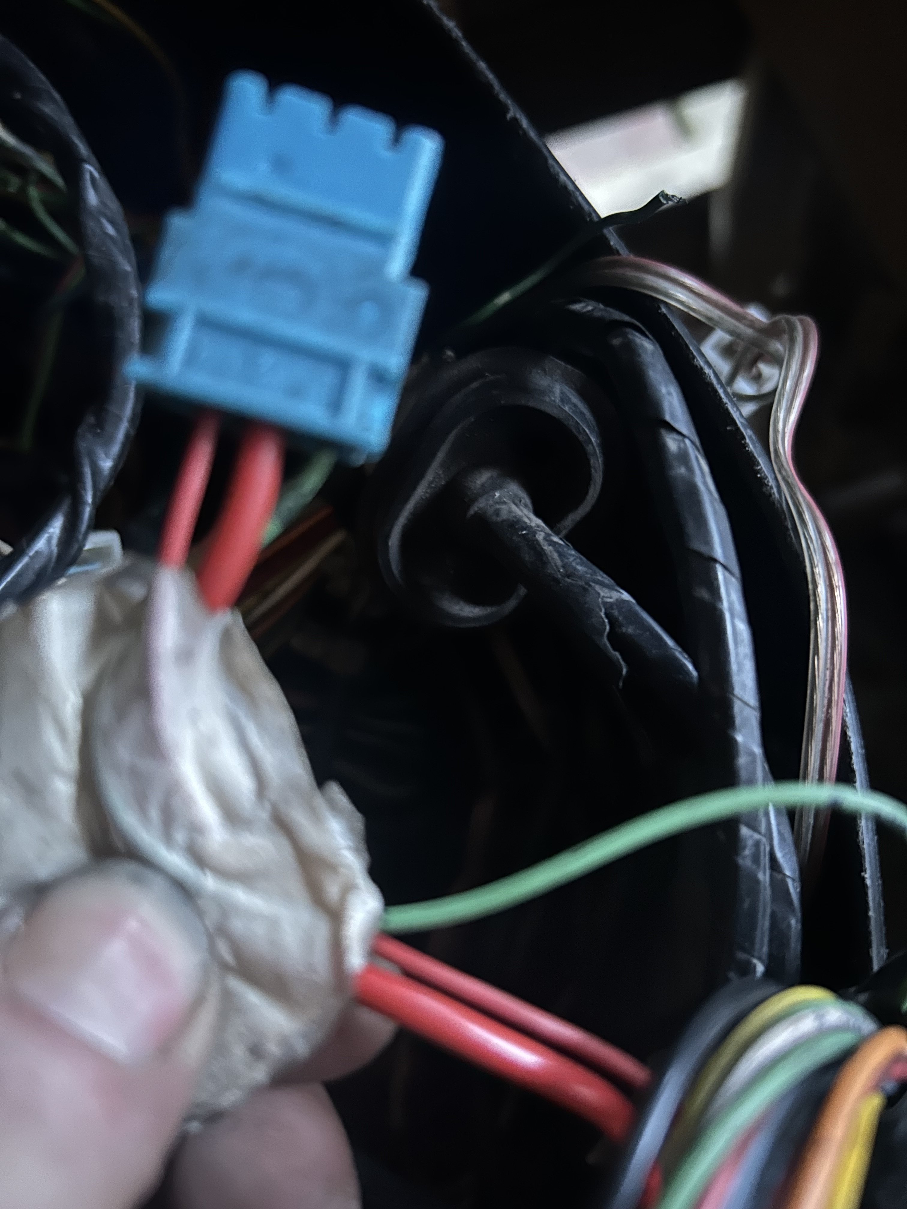

Any you guys help us identify where this green wire number 57 goes in engine bay it been cut. I found the other end in fuse box board 3 pin blue plug E we still sorting this loom out phase 2 1.9 gti Haynes wiring no good
Switched live for the relay system on cars with twin cooling fans, goes to the red plug behind the left headlamp, unused on most vehicles.

found wire 57 in fan loom  aswell and is separate loom ? Where’s the other green 57 go got no red plug near headlight

Mc4 rg plug would that be taped in are loom then with no plug not used? Getting there thanks guys
no it'll be a red 2 or 3 pin male plug near the left headlamp.
