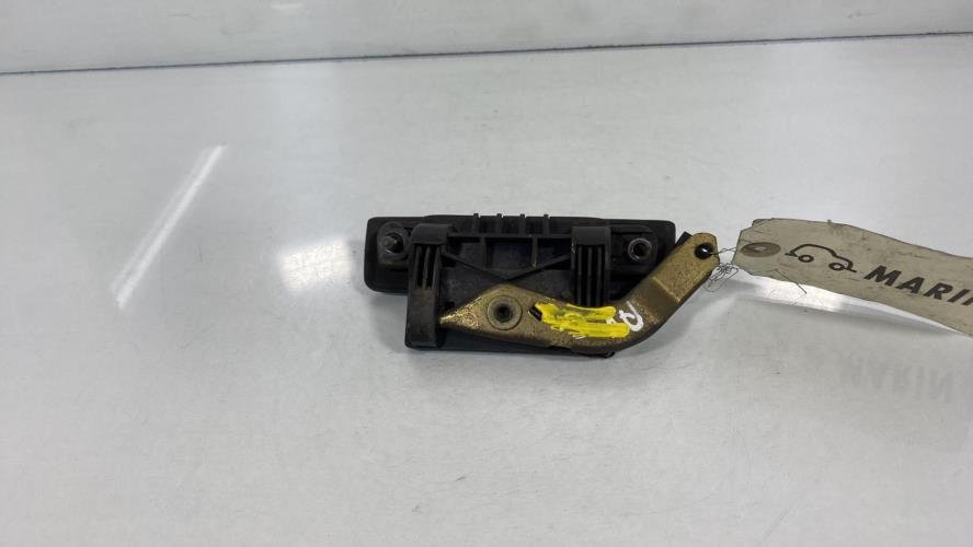

Ozymandis
It will be the actual exterior door handle not the internal operating rods, catch or lock.
Rust in the handle mechanism makes the operating arm too tight to be returned to its resting posistion by the spring.
Imagine holding the handle open and trying to work the lock and catch, this is effectively what is happening when they start to sieze.
Try making sure the exterior handle is down and repeatedly whack the area with the heel of Your hand, this sometimes shocks the siezed parts and the door can be opened.( Using the inside handle or it will just stick again as soon as you operate the exterior handle.)
The cures, remove the exterior handle, then (use real oil not wd40) lubricate the siezed pivot of the operating arm on the back of the handle whilst working the handle, then do it again in 5 years or so. Or get a better handle.

Ozymandis
The metal operating lever`s pivot point is sticking, it`s the circular metal rivetted over part to the left of the yellow paint, that needs oiling and working to free off the operating arm.
Piece-Poignee-porte-avant-gauche-910173-PEUGEOT-205-PHASE-2-9519a4e4e31bab9a0eb78ba03076d6b0e6f404d3fafffb03aea4dc569e328c64_mtn.jpg
