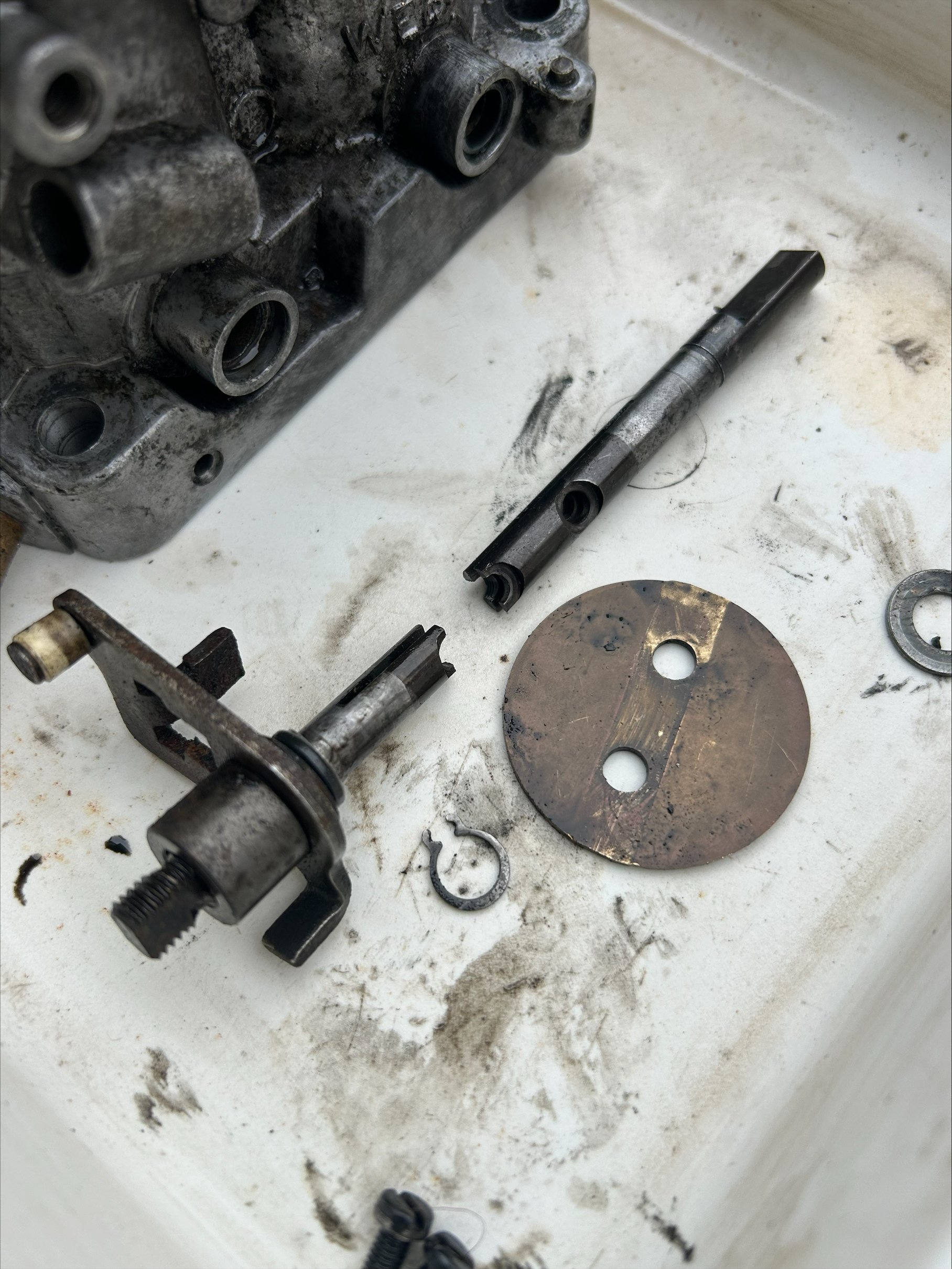

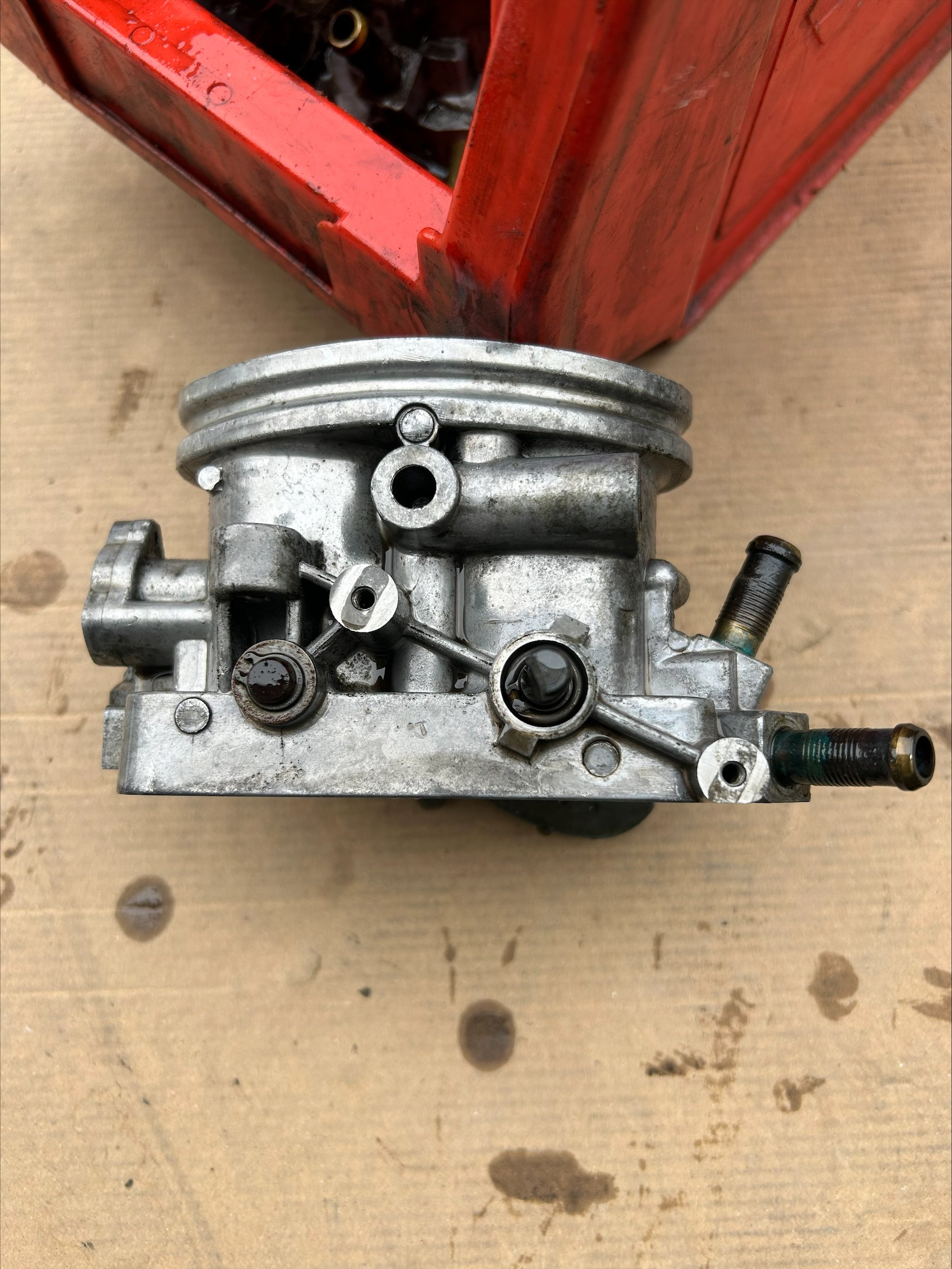

If i am going to start the engine on the original loom and management i thought i ought to have a look at the 2 inlet manifolds and throttle bodies that i picked up with the engines i bought , i know the linkage has a reputation for wearing out so i was hoping i could recondition at least one of them . I had noticed when i bought it that one of the throttle spindles was broken and after cleaning with degreaser i stripped them both down , one of the spindles was in 2 pieces and there was some damage to the quadrant probably caused by overtightening . The tiny white plastic roller on one linkage was worn but the other is ok so i will be able to make one good throttle body out of the two . I will get the casting vapour blasted and the steel parts replated .

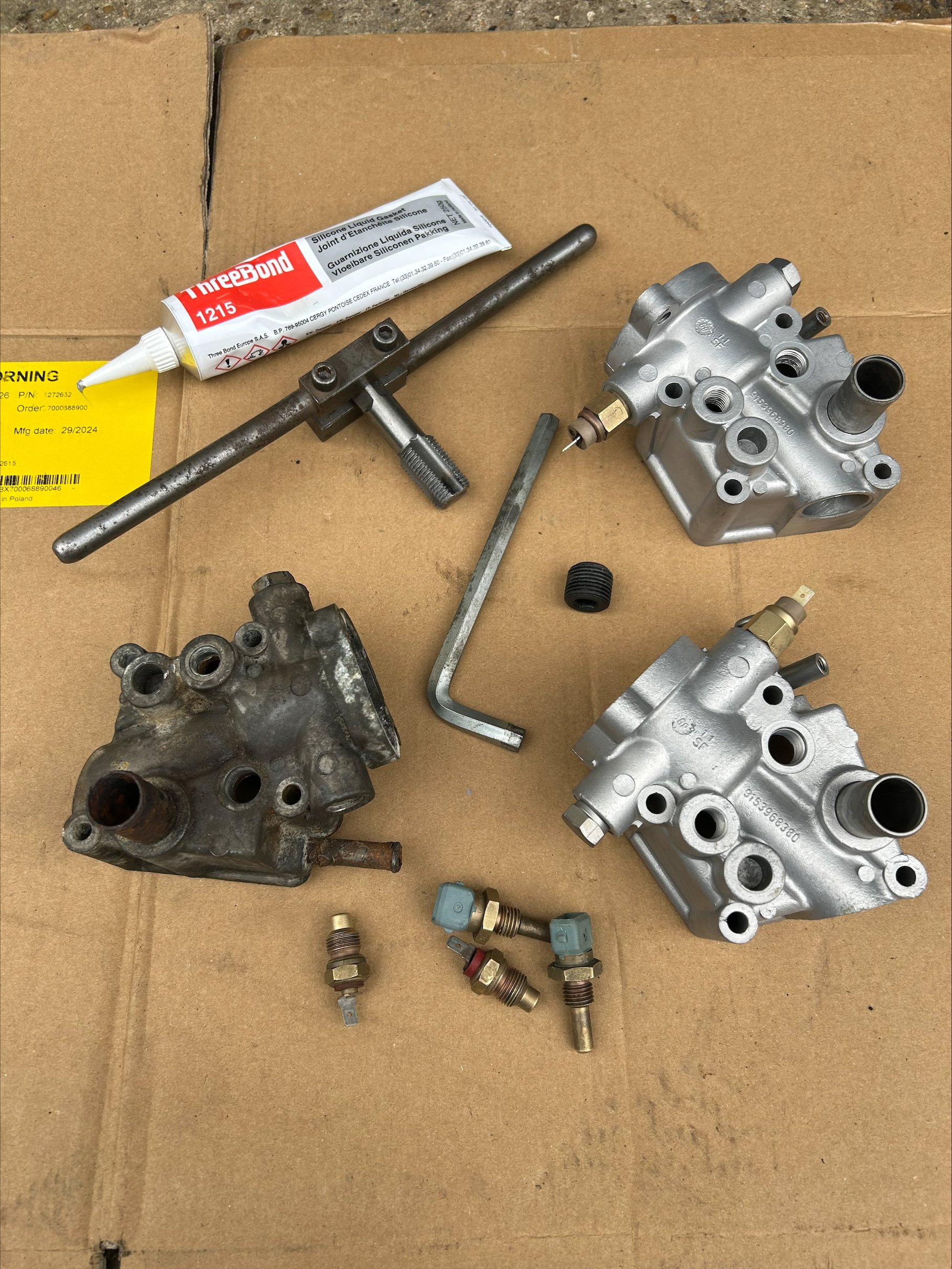

hoodygoodwood

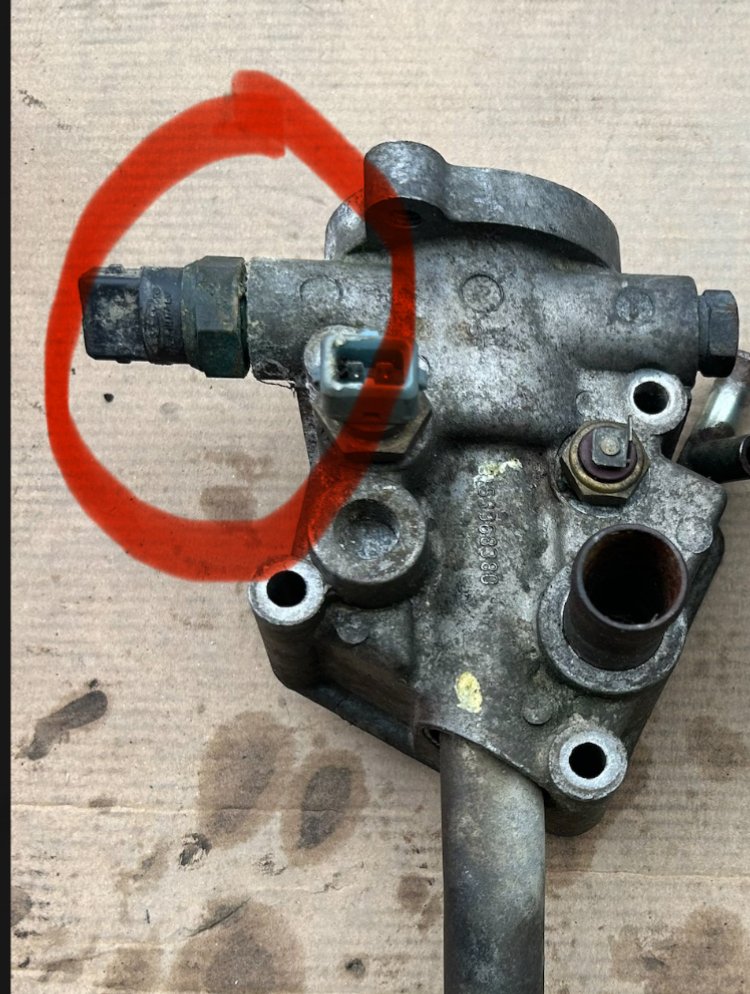

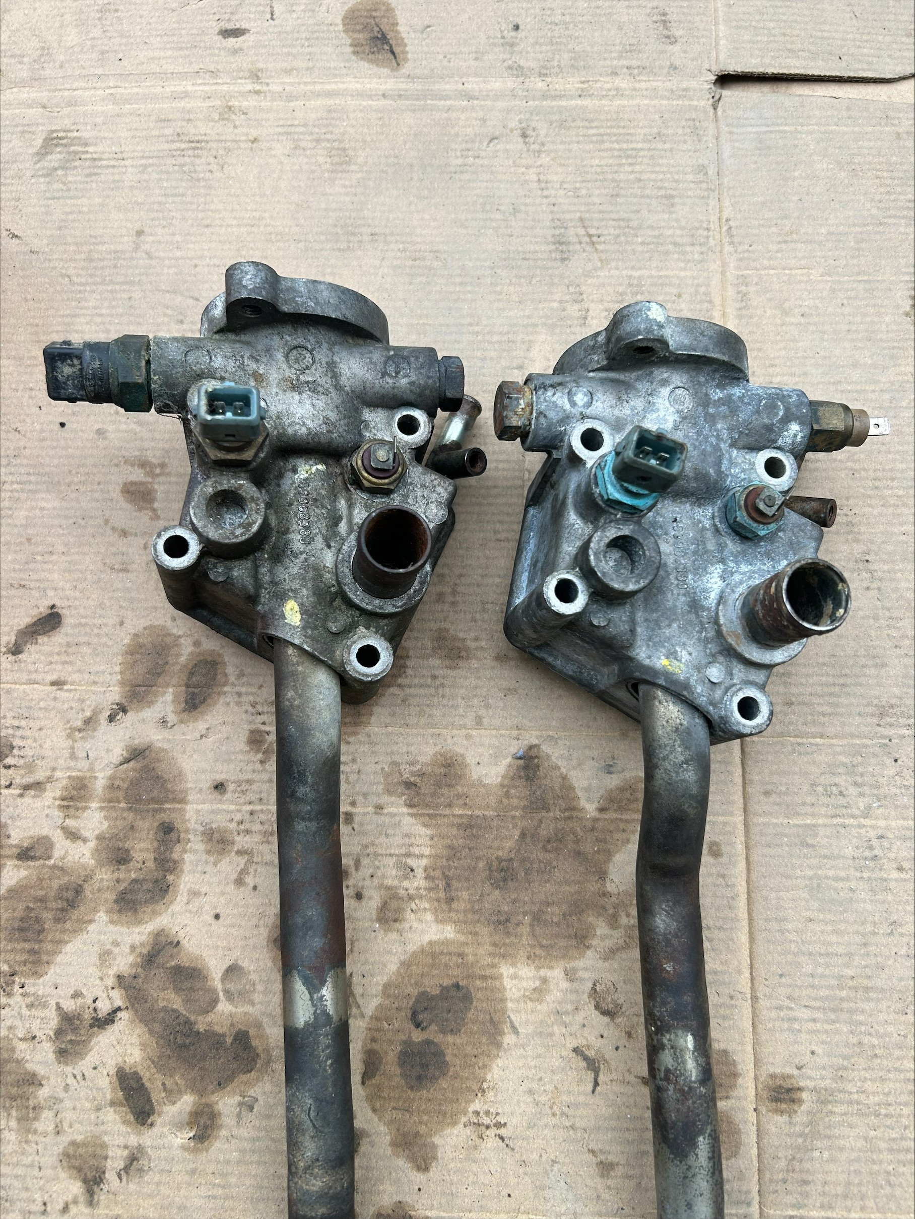

I have 3 of these mi16 thermostat housings , i am going to run the engine without the steel pipe along the back of the head so the steel pipe coming out of the housing is not needed , i am sure i read that this can be pulled out of the aluminium casting if you apply some heat - is it soldered in place ? I will try to remove it and then plug the hole with a piece of aluminium i will turn up to suit . My 3 have a variety of sensors/switches fitted , the blue ended one is obviously the water temperature sensor and the one to the right of it looks like the sender to the dash . What is the black one at top left of the pic - something to do with air con ?
Leslie green
I suspect that steel water pipe end is just an interference fit with some loctite on it , I took the small one out of my gti thermostat housing for plating without heat but left the big one as I suspected it would break on removal .
both single pin are for the dash, one is warning light switch and one is for  the gauge, the switch might have the temperature on the side.
You need an oxy-torch to remove the pipe, then tap 1/2 BSP or NPT.
It’s better to use an XU10J4 housing, then you have the option of a cam trigger.
The sensor circled normally controls the Bitron unit and cooling fans. Just delete it.
Edited by petert
hoodygoodwood
I have removed the unwanted water pipe from my 3 castings , used my propane gas torch and just twisted them out . I have got a 1/2 inch BSP tap and some plugs on order to fill the hole . I have just stripped my engine block down and i am relieved to find the liner seats and other areas that can suffer from corrosion are all in good order so i will be taking a boot full of castings for vapour and sandblasting soon , before i take the Mi's alloy sump i would like to remove the boss's and mounts for what i assume is an air conditioning pump - are they used for anything else ?

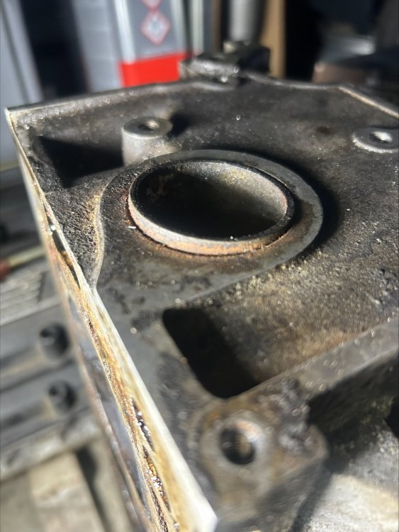

The large core plug on the end of my Mi16 cylinder head has moved out about 3 mm on one side , i have not changed one in 30 years but i would like to remove it and fit a new one to be safe . I will measure it and buy one of the same diameter , what sealant should i use when refitting to make sure its watertight ?
ThreeBond 1211
SRDT
Part number 0153.05 and Ø42
I will look into the modern replacement Bosch injectors .
A gti6 inlet manifold and throttle body can be made to fit quite easily, and is a worthwhile upgrade. Plus a newer more reliable throttle body.
I had an MI throttle body spindle snap like the one pictured and end a TrackDay early, almost ruined an engine - luckily found the screw in the inlet manifold!

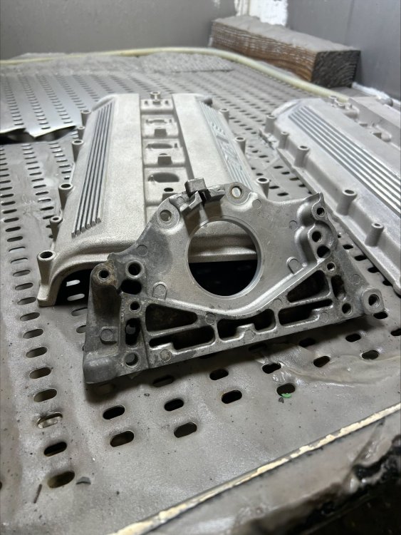

Thanks for the advice , have got a pair of my thermostat housings wet blasted after removing the steel pipes and plugging the holes as recommended . Took a load of other parts down to a new place and got some sand blasted and the others wet blasted , so lots of painting to do this winter .

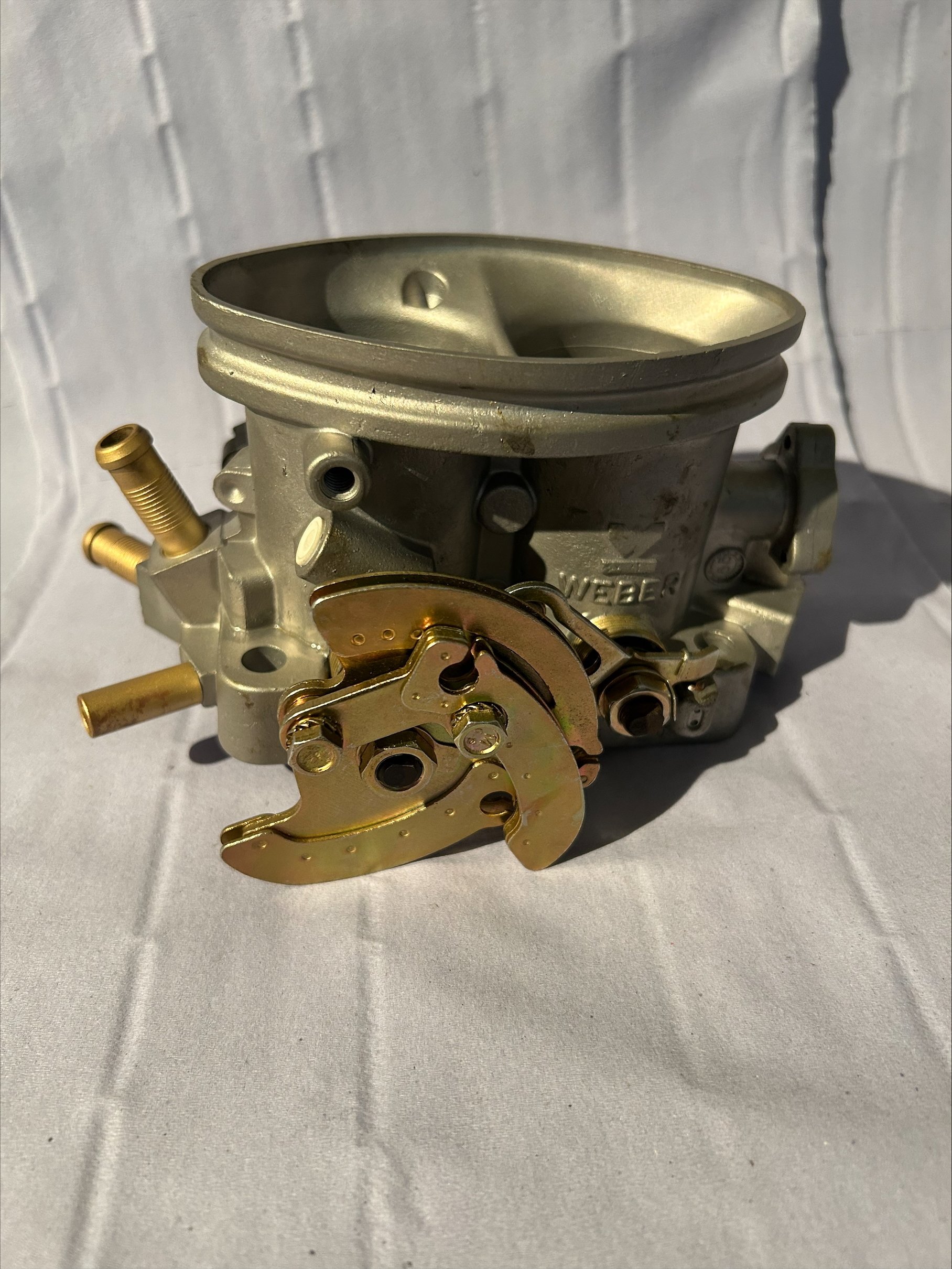

hoodygoodwood
Made one good throttle body out of the two i have , got everything blasted/plated and picked the best bits and it seems to work well . The TPS that came with them was faulty of course so i fitted a good spare that i already had .
