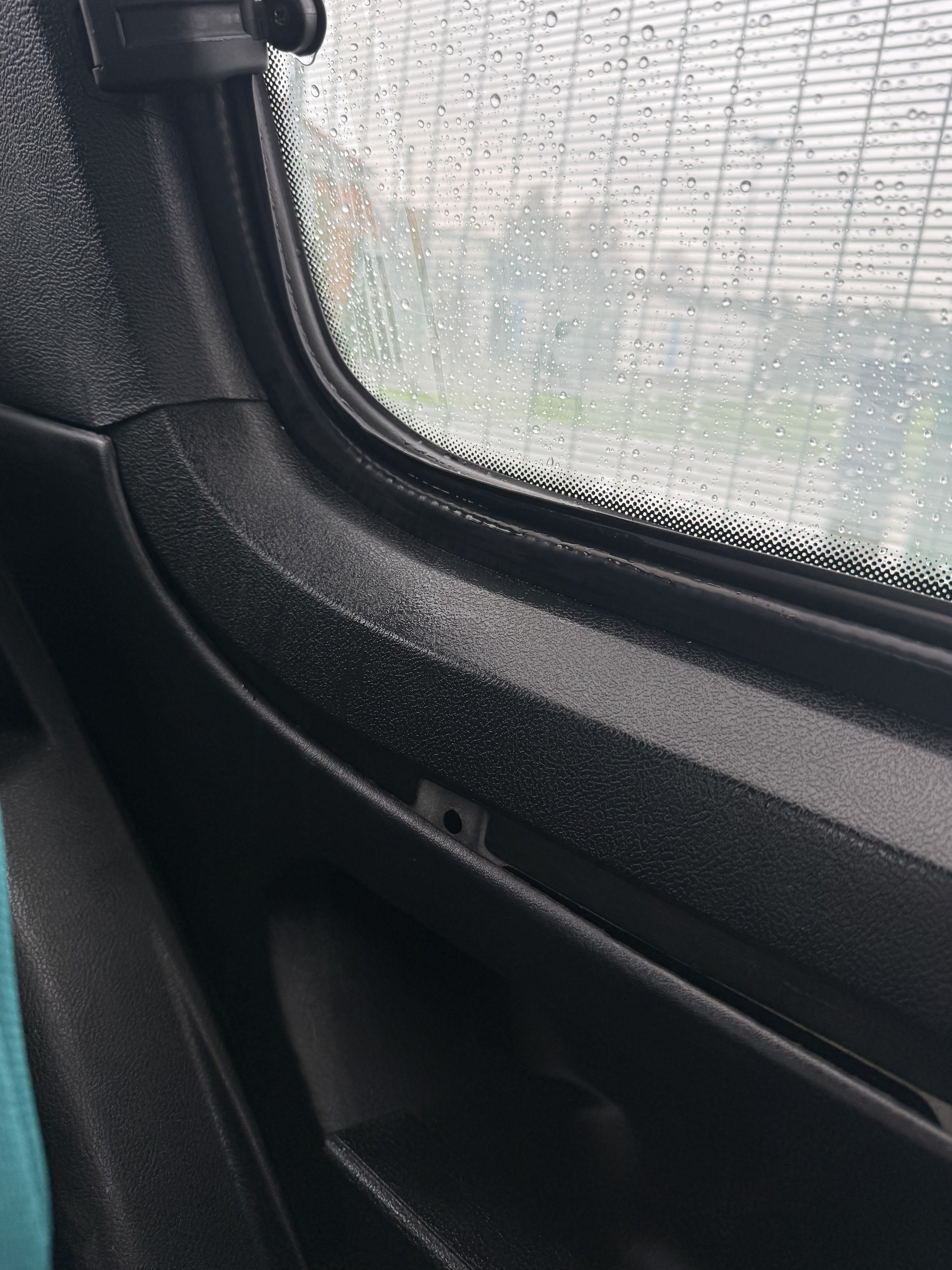

my youngtimers seals leak so much I’ve had to take the car off daily duties.
where are you getting your leak coming in Anthony?  Mine is collecting in the channel immediately below the window. I suspect the seam of the window along the bottom needs sealing as I can feel wetness all along the bottom of the window seam if that makes sense. This was the case before I put the youngtimers seals on.

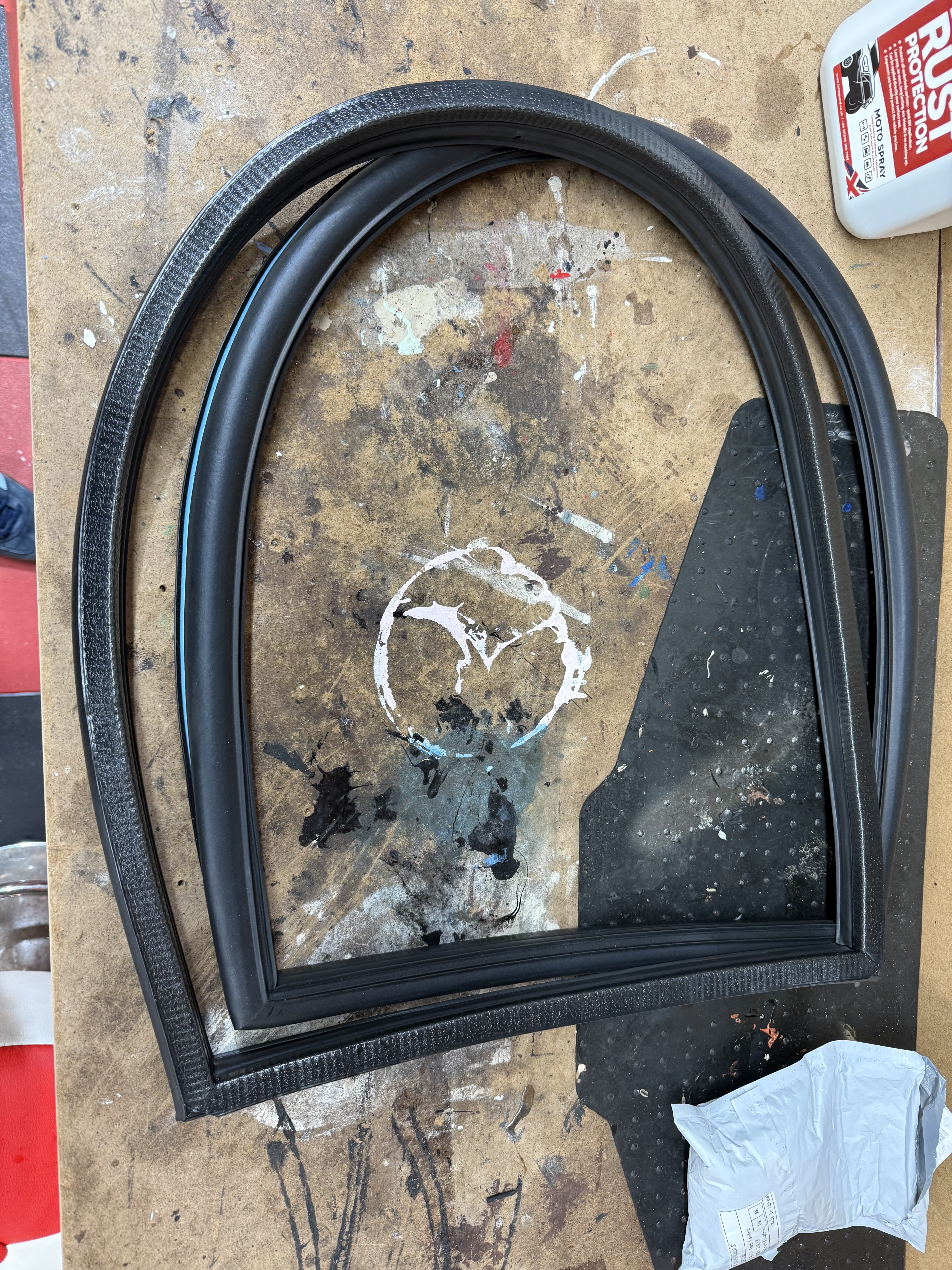

Seals arrived from Peugeot Museum (inc £56 import tax - argh!)
yet to fit but look identical to originals so fingers crossed!
ScoobyJawa
I got mine a while back from the museum too, they look identical to oem, but not yet needed to fit. I also got the front seals which are the same and on the passenger side seems to have fixed the leak I had in the passenger footwell.

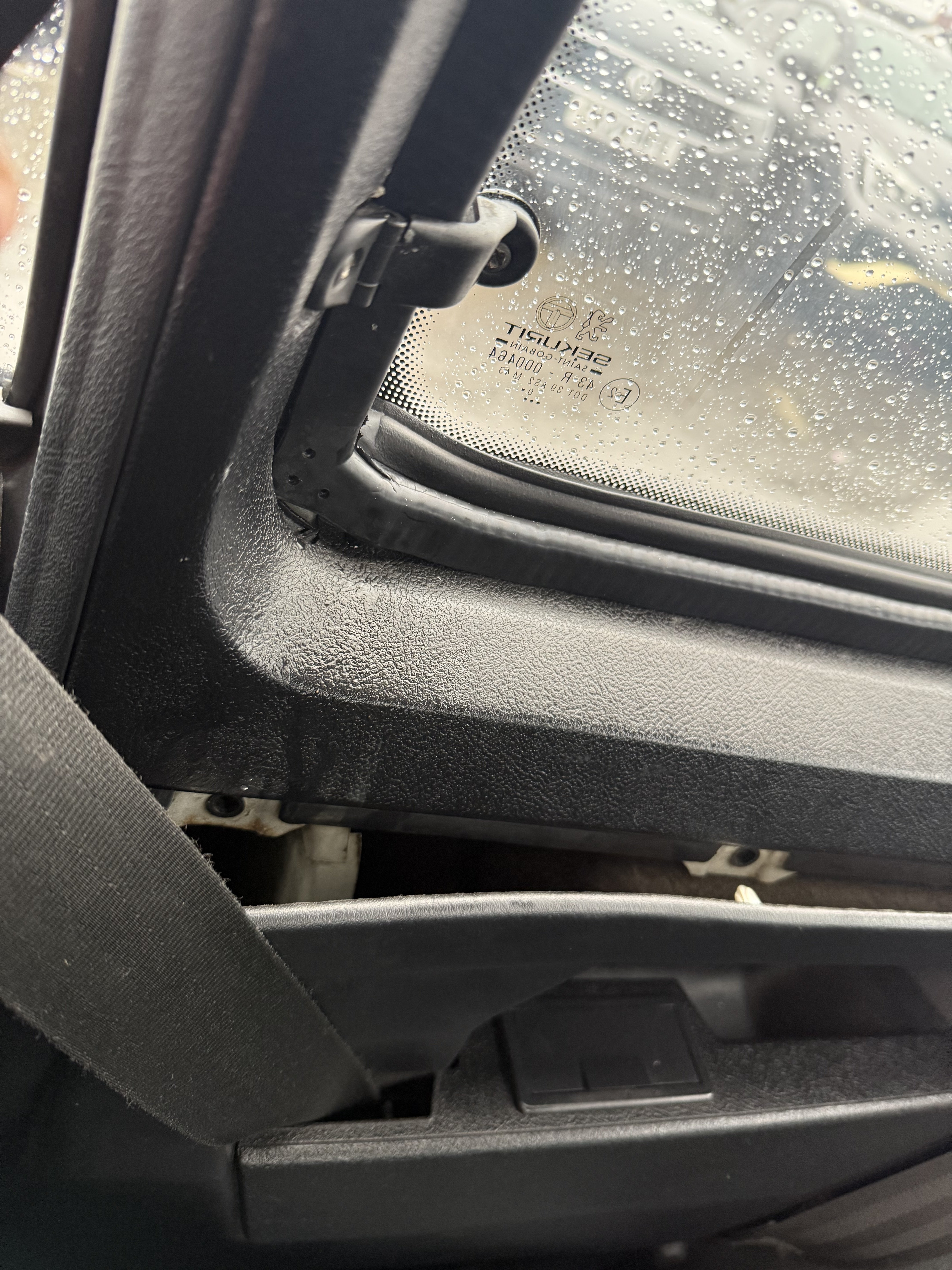

With the original shrunken seals I was getting a small amount of leakage past the seal and onto the plastic trim below the seal, although not so much as to explain the significant amount of water that was ending up in the rear seat footwells after prolonged periods of heavy rain.  My best guess was that it was getting past the outer part of the seal at the top, running around the seal inner channel and then through the join between the inner and outer panels, trickling down the rear lower quarter trim panel and then out of the vent at the bottom into the footwell.  At its worse you could see the water dripping through the vent, and there was often tale-tale track marks from where the water had been.
With the new Youngtimer seals, I have yet to see any moisture on either the seal itself or on the plastic trim around the window, but I do still sometimes get a small amount of water in the rear footwells which subjectively appears to still be coming from the bottom of the rear lower quarter plastics, but no visible water or track marks now.  I would say that the YT seals have cut the leak to maybe 1-2% of what it was and often there is no leak at all - there's been nothing over the entire Xmas break and into January for example - which makes for frustration trying to locate the source of the leak (as I'm not entirely convinced that it is still the seal and not something else) and means I can't put the carpet and sound deadening back in.
