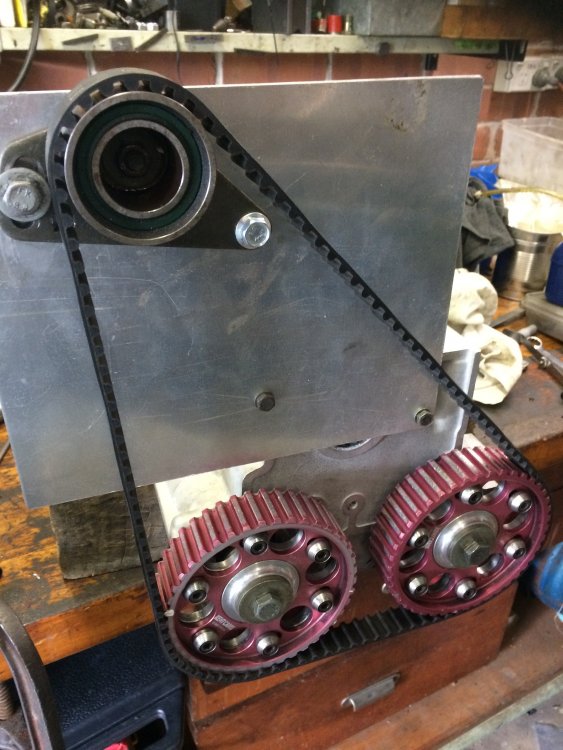

Sandy has asked you a very difficult question. It's impossible to measure without having the head fully assembled and timed on the bench. With big valves and big cams you need to verify this figure through the full engine cycle. I use this jig below and set the timing where it needs to be and then wind it around. The generally accepted figure is 0.030" min.
The other pic is a fail, where I used Ø36.5 inlets and Ø30.0 exhausts with monster cams. If I had of used Ø35.5 inlets it would have worked. It becomes a case of you can't have your cake and eat it too. I had to use a smaller inlet cam to solve it.

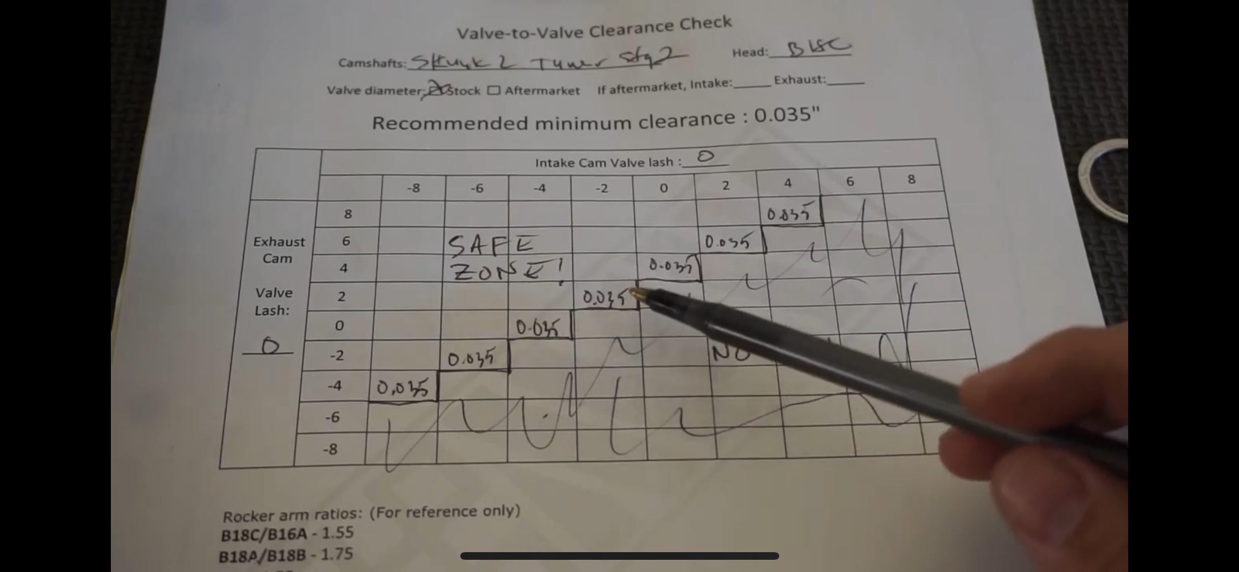

I was going to make up a chart something similar to what I saw in an online video
