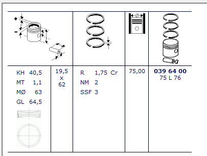

I think you might be right. Mahle catoloque says normal and 106 xsi are the same pistons. Maybe you do not have to use PSA pistons though. The first turbo I build had 76mm R5 GT turbo pistons. Not easy though. Because of the fact the pins are pressed into the rod (19,5mm). But it is possible to use 20mm pinned pistons like the R5, if you have possibilities to hone. With 20 mm pins you have more options of pistons I think. What I did back then was put 2 pistons on one pin and then clammed the bigends together. Removed the pin and honed 2 rods inline from 19,45 to 19,95 mm. Worked a treat. That does make things complicated, but i think 20mm pins are far more common.
Do you mean this one?
https://web.tecalliance.net/mahle-catalog/en/parts/287/039%2064%2000/detail?groups=443#@brc/articleNo:039%252064%252000
I'm not sure they're right about that. It's 40.5 mm tall and has a 1.1 mm dish in it, and I thought the XSI piston should be domed. I think my calculations showed an average piston height of 41.5 mm in order to get the right compression ratio - I'll double check that later.

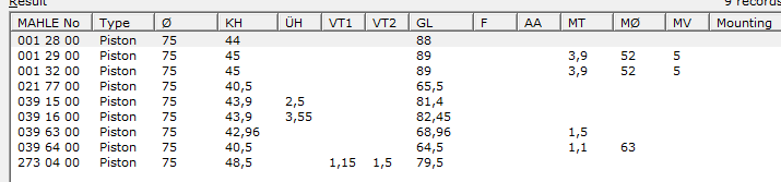

Yes, I mean that catalogue. But from memory the xsi is domed. It been 20 years since that though. I have a mahle cd still. The program on that cd let’s one reverse search.
XV3 seems to ave 44,5 KH
image.png.1c607608d2c874f3fe790affa2517988.pngimage.png.4621787d63ea890211f9fa7b30109e9e.png
I found that piston by looking up the TU3FJ2, as far as I can see it is the only piston they recommend for all versions of that engine. They also recommend it for many (most/all?) other TU3 variants, so I don't think it can be right.

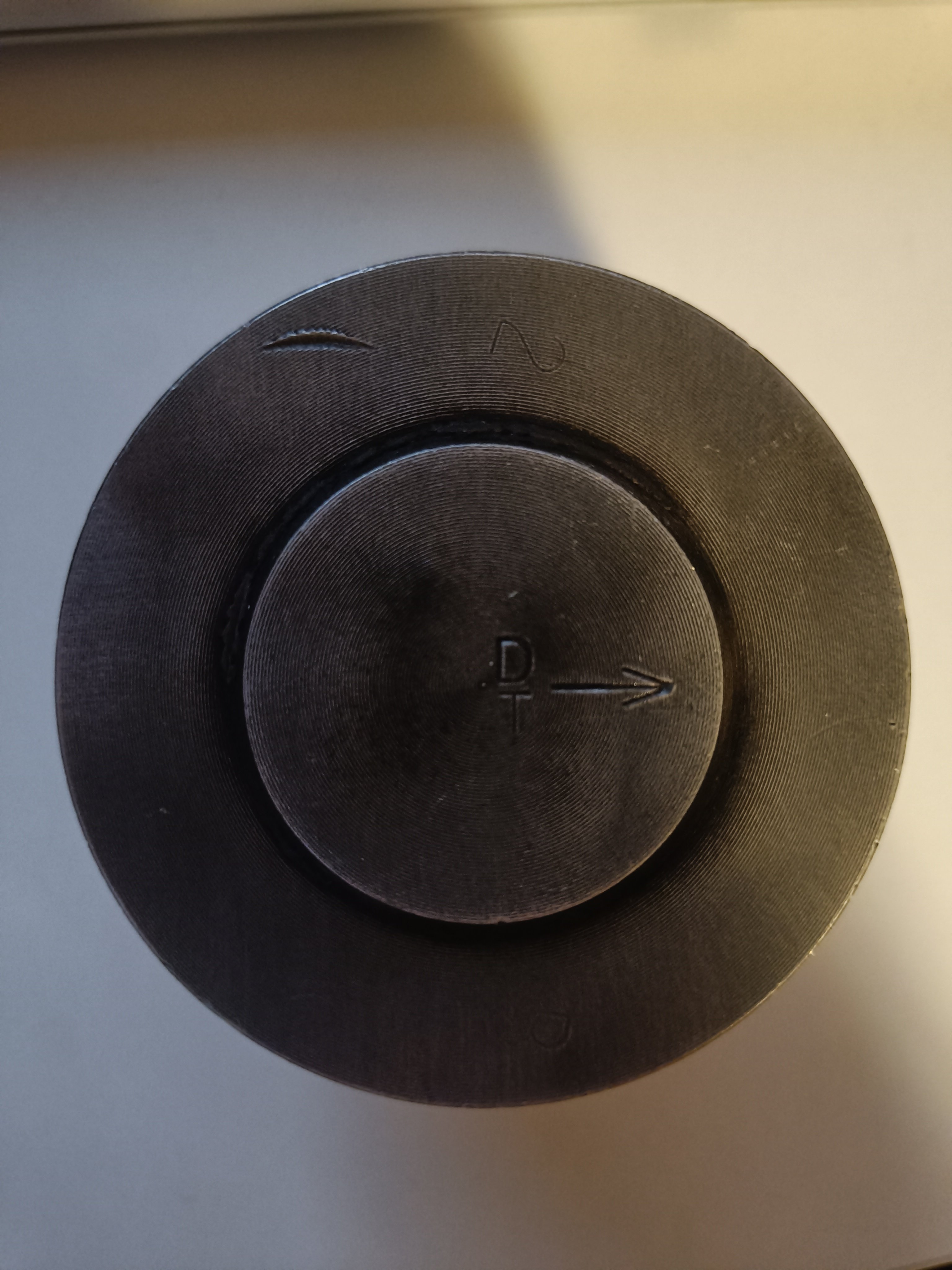

In the meantime I've done a quick comparison between the original TU3 piston and the TU24 pistons. The TU3 one seems to be around 3mm taller, and of course with 5mm longer stroke from the TU5 crank I'll only move it up by 2,5mm... But the TU3 piston is dished while the TU24 is domed, so combined with the larger displacement I still think CR should end up somewhere around 10:1.
Assuming, that is, that the head volume really is 32,5cc. I haven't measured that yet, but I will. The head looked pretty clean, so I think it might have had a skim or two in its life already.
